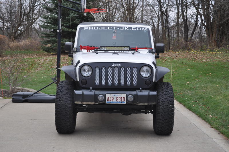

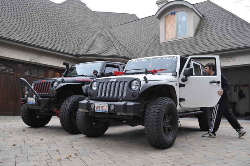

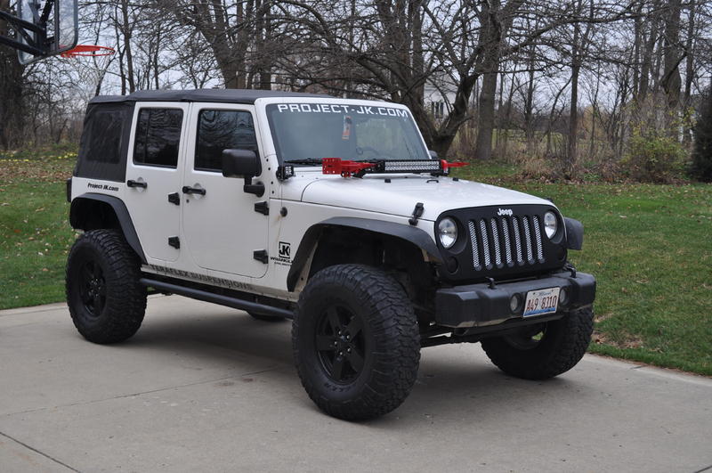

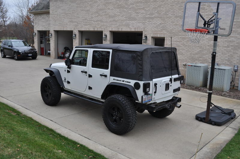

That size lift is not needed... Plus you say the bigger the better but 37's will just look small on that then... Research is definitely needed if you start going above 3 inch of lift... Im running 37's with 2.5 inch teraflex coil lift and a 1 inch body lift. I chose to cut my fenders because I like the look. Go with a 4 inch lift and leave it at that... Id much rather go with that size lift anyways if I was running 37's anything about 4inch means new axles and 40's or more to me... well here is my jeep with my lift and 37's Click image for larger version

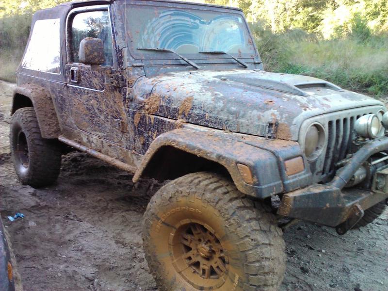

my friend has a 5.5 in lift and 35's and it looks amazing. he has a 2dr 06' tj and it is the perfect
height
