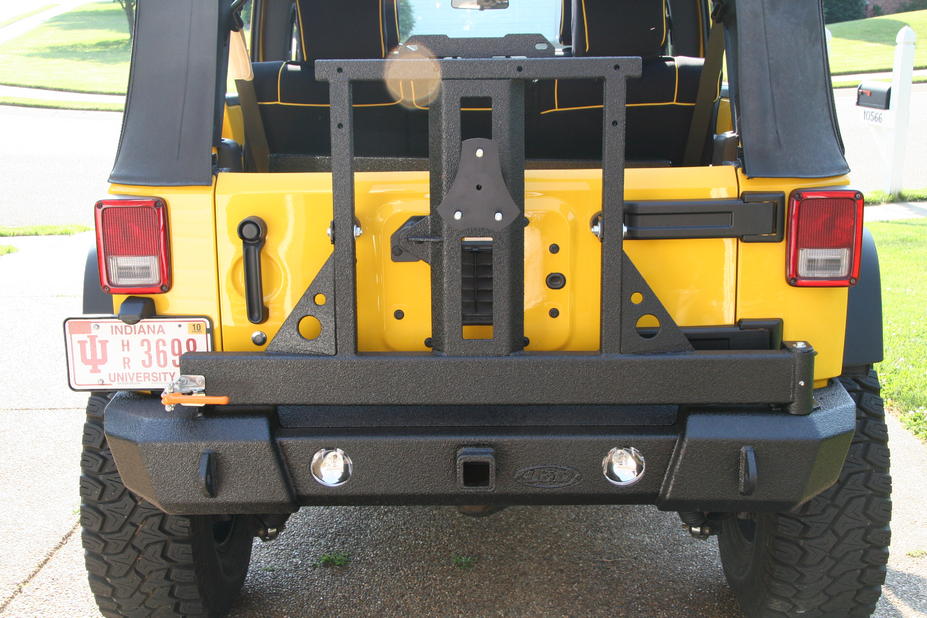

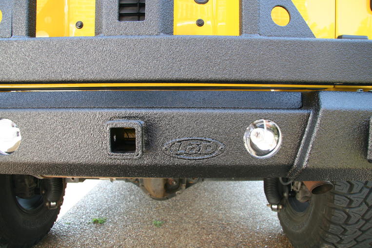

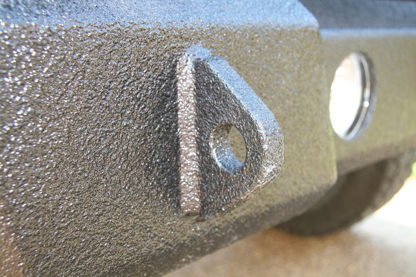

Here are a few pictures

I love the look! Just curious, why did you cover the logo?
