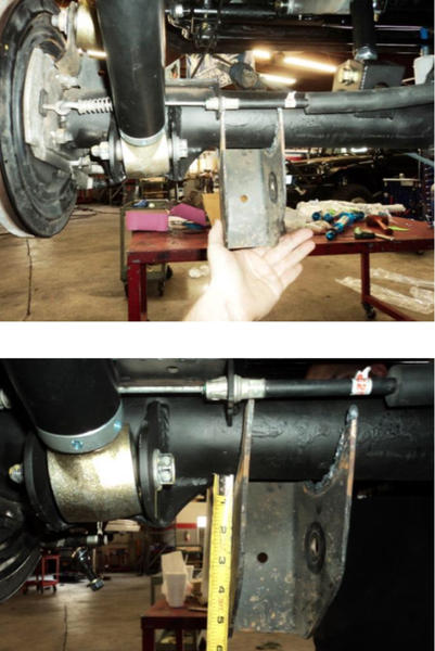

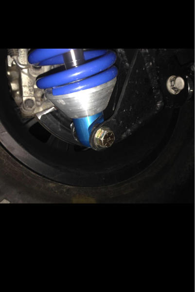

The evo high clearance bracket kit is designed to work with their cantilever system. But it can be modified by welding on shock mounts wether using coilovers or not. I was going to do this mainly for clearance on the frame side mounts.
A picture of what I mean.
Those are 2 different items in the pictures? Frame side mounts? Maybe Im misunderstanding.
