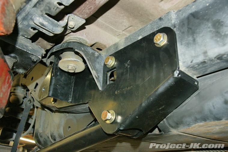

Synergy and EVO instructions are to partially cut the rear body mount and install the bracket to what's left. Does that provide enough length?
Here you can see the problem. Even with the bracket trimmed, the rear upper arms are quite a bit shorter than the rear lower arms.
The Synergy arms are closer in length:
Here is a pic of the Synergy bracket as a comparison to the EVO:
The Rock Krawler 3rd link isn't as long, but the vertical separation on the axle mounts is greater.

Planman -- the EVO bracket pic is the high clearance one they said only works with the Lever (and those arms are no longer available). Here's the bracket that is included with the Double D longarm kit and is what I was told works with the bolt-on coilovers. It's still a big delta compared to the Synergy bracket.
And if you look at the Double D kit on EVO's site, there's a significant difference in lengths between the UCAs and LCAs.
