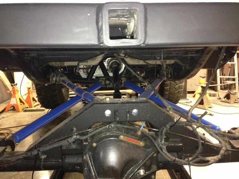

I've personally seen it with Mel, Bob (TnT), Jeremy (Rock Krawler), Dave (Synergy), Dennis (not an owner, but a rep for Teraflex), Tom Woods, Jim (JE Reel), etc., etc.
The Rock Krawler trusses are boxed in, with much more welding surface.
Here is my original Trailmaster truss that is based on the Rock Krawler design:

It was basiclly just a 3/8" bar bent around the differential and just welded at the tubes. I think it was bought from a small fab company. His build thread is on jkfreaks his tag is CJ that went JK. I use to wheel with him from time to time when I lived in Illinois.
Old Apr 7, 2014 | 08:36 AM
  #60
TheDirtman's Avatar
Posts: 6,222
Likes: 376
From: Southwest Reno, NV
I use the genright bridge that I cut down a bit and modified it to bolt the the dynatrac differential as well as being welded to the tubes. It allows you to use a 3 link or 4 link setup but does mount the joints vertically instead of horizontal.
