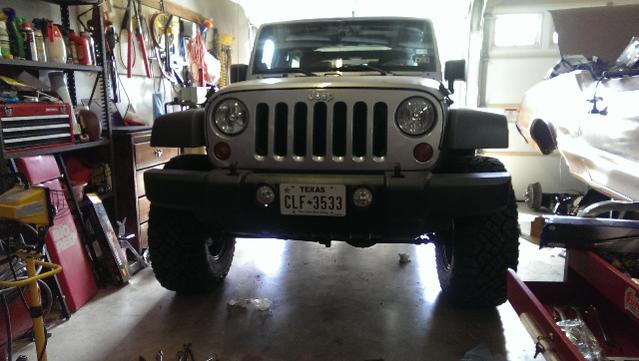

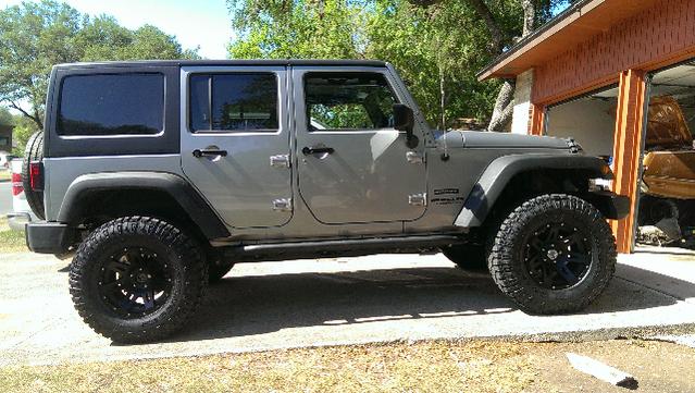

Installed the 3.5 Dualrate ARB this past weekend with exhaust spacers spacers. DS still looks close. Ride is firmer, playing with tire pressures. Corners flat. Steering feels a little disconnected. More play at high speeds. Alignment done caster within specs but strangely camber is off. Ball joint? With only 8k miles.

What size tires are you running? Looks great!

[QUOTE=RocketLab;3906308]Installed the 3.5 Dualrate ARB this past weekend with exhaust spacers spacers. DS still looks close. Ride is firmer, playing with tire pressures. Corners flat. Steering feels a little disconnected. More play at high speeds. Alignment done caster within specs but strangely camber is off. Ball joint? With only 8k miles.
It is not uncommon for a lift to reveal underlying issues. What is your caster and toe-in? Many people find a little more toe-in fixes the steering feel. I had the same issue and added a little more toe and that fixed it.
