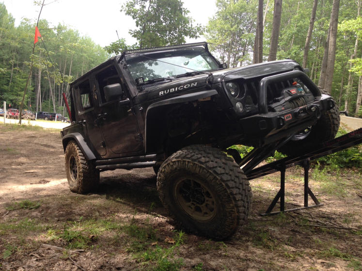

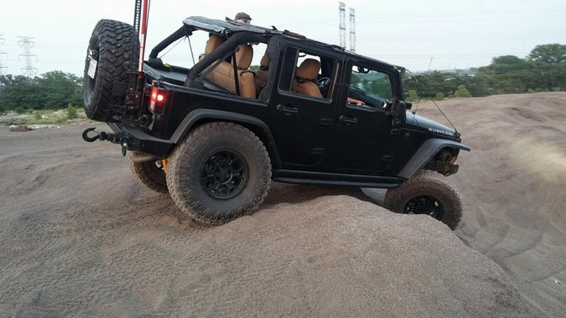

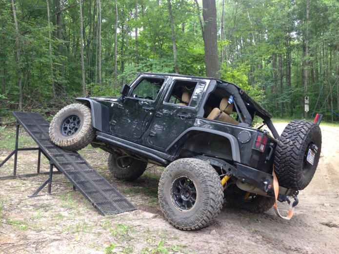

OME all the way. Nice flex. Great ride. No issues. Look good. Paintable.

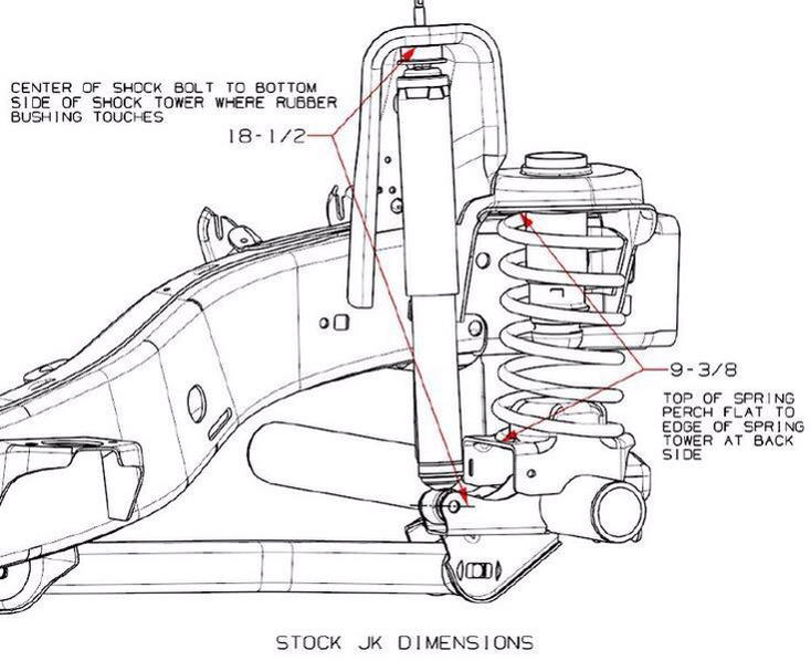

How and where did you measure that??? It does not look like 5,5" of lift to me.

^^^agree.
Try this to get an accurate number.
