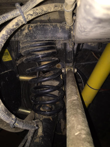

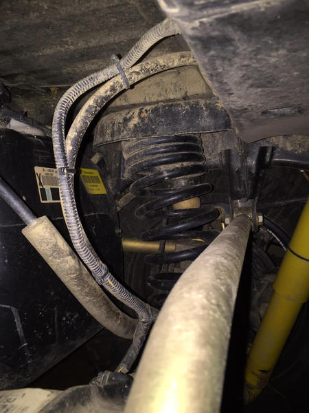

as you can see my rears are curved. my front springs are not. isn't this due to the slight rotation of the axle for the increase angle of the driveshaft?

Yes, and in both of those photos the coils are bowed.

how do i fix the rear coils then? do they need to be rotated?

In an ideal world yes cut them off and rotate them. Some people will not do that so they make coil wedges as well. I do not know it metalcloak makes them but i know rock krawler does.

Did rear control arms come with your lift? It looks like that axle has been moved back quite a bit

yes the rear control arms did come with the kit. its the metalcloak 3.5 ARB kit. maybe they need to be adjusted?

Like Mertz said. Cut off the old perches,rotate them back to the top of the axle, and weld them back on. If welding is not something you can do JKS makes a new coil perch that bolts on and is adjustable.
