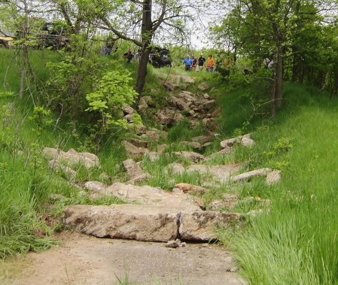

The Jeep, in the picture on the left, has air springs lift. In the picture, the lift is at its max', about 8"~9".
At the time, except for the air springs and Fox shocks, everything was stock, including the arms, wheels and tires (245/75/17).
The Jeep climbed that step quite easily, just touching the right side-step.
Without that much lift, it would have sat on its belly.
On that step, regular long arms would have pressed against the ground, while the short arms didn't.

The Jeep, in the picture on the left, has air springs lift. In the picture, the lift is at its max', about 8"~9". At the time, except for the air springs and Fox shocks, everything was stock, including the arms, wheels and tires (245/75/17).
