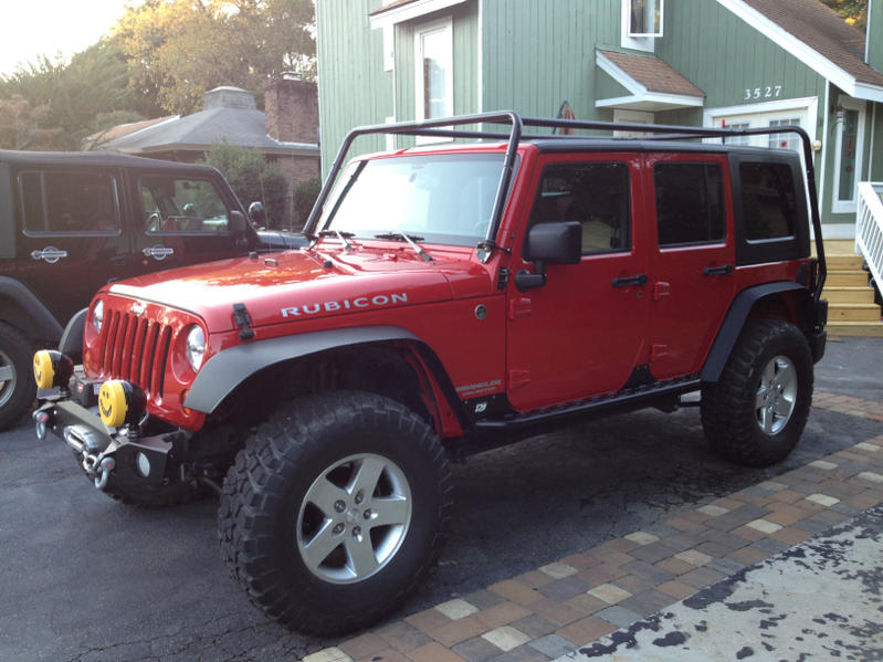

SBEII's Avatar
Posts: 1,975
From: Myrtle Beach, SC
35" tires on a 1.5" leveling kit.

Old Feb 12, 2013 | 05:49 PM
4x4Play's Avatar
Posts: 119
From: Fort Hood, TX
That looks great! Exactly what I'm looking for.
