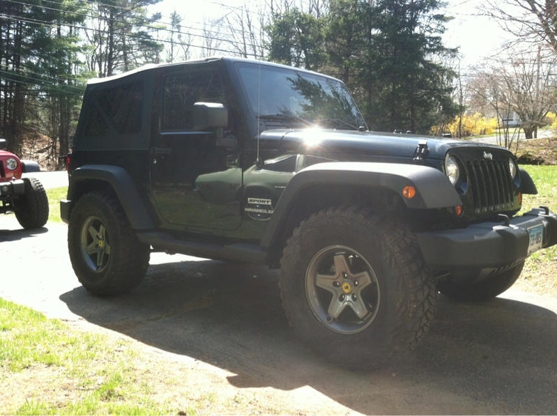

Would using body spacers (2.5" front & 1.75" rear) and switching to flat fender flares create enough clearance to put 35's on my Jeep? I want to put them on my 17" Rubi wheels.

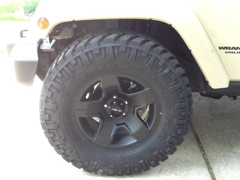

We put some 18/56 JKU springs on our 2012, basically gave 1.5" lift up front and .75" rear. Out of boredom we slapped my 35's on it. With flats it would prolly work very well with some extra bump stops. No rubbing on flat ground lock to lock.
Yeah 4dr springs on 2drs net about the same as a leveling kit. A guy around here is running that setup.

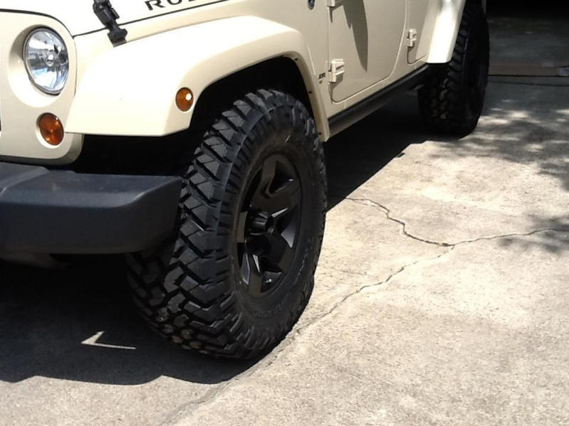

Stock fenders the entire time.
Old Feb 15, 2013 | 01:33 PM
Jeepstin12's Avatar
Posts: 2,482
From: Denver, CO
After the lift. I'll try to find pre lift pics.

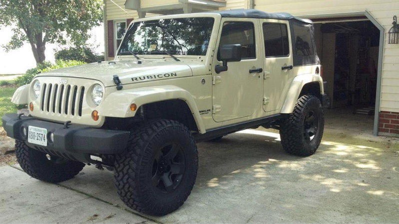

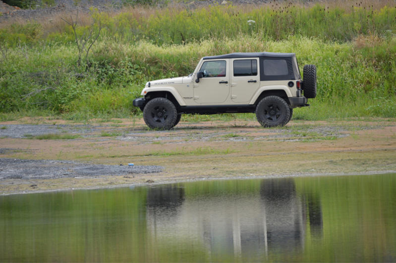

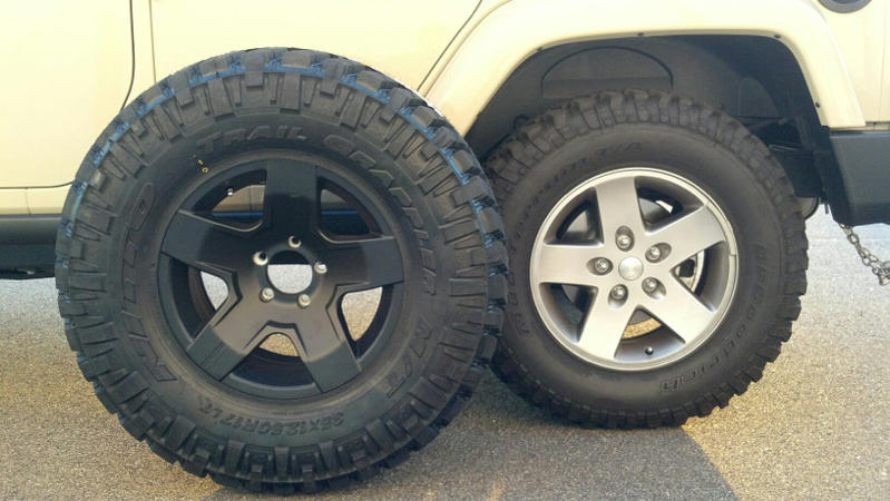

Here are some pics of the 35's mounted, stock suspension.
ID:	423005   Click image for larger version
ID:	423006   Click image for larger version
ID:	423007   Click image for larger version

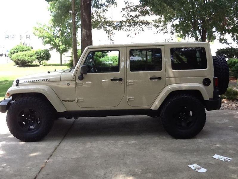

After a Full Traction 3" lift, fox 2.0's, etc.
ID:	423010   Click image for larger version
ID:	423011   Click image for larger version
