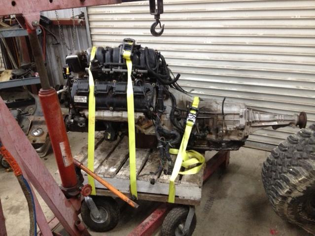

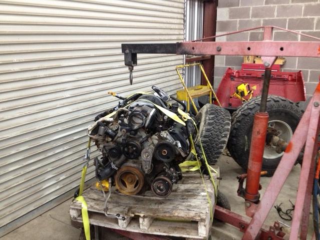

Finally got pics of my hemi, it's now at a good friend of mines shop in Texas. He agreed to do the conversion for me so right now he's going to fix anything wrong with the engine and transmission and from there we'll get the correct and best conversion kit and needed parts for the install.

Yeah thats at least an 09 motor. Go the hotwire auto route. I did. I sourced all my parts myself and came out cheaper than the package deals but in hindsight, a package deal wouldve been easier. I just suck at saving dough, so I bought parts as i went. The motor looks pretty rough, but after getting it cleaned up you can check for sure what you might need. You will need to change the tailshaft for sure. That will add a little. Looks like you have the correct manifolds too so that is good. I would just toss the old harness and computer. You wont need it. Hotwires harness is complete.
