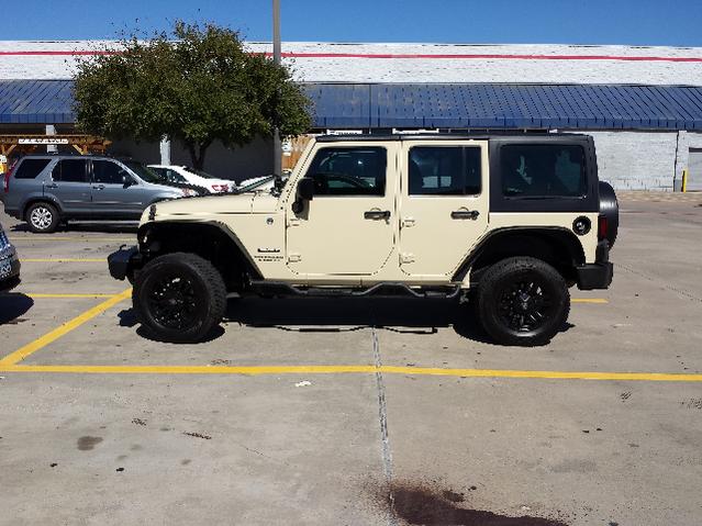

I have a Teraflex level kit 1.5 in, 2" spacers in the front and 1" in the rear. ProComp 9000 shocks for this setup and SmittyBilt XRC flat fender flares, at the moment I have 265/70/17 Cooper Discover ATs about 31.6 dia. I bought the tires the same week I bought the Jeep in August 2013, then bought the level kit, shocks, and fenders last month. I wheel mainly in the desert and mountains, ie west Texas, Davis Mountains, Big Bend, and some Colorado, also some east Texas Piney Woods. What I'm looking for is your opinion on how big of a tire diameter can I get by with, I also have17" MB TKO wheels with 5.5" backspace. The 265s look really small now but I wont ever wheel enough for 37s more some medium trails and camping expedition stuff. Any opinion from you would be greatly appreciated, thanks in advance.
I had the same set up and pretty much 285/70-17 ie 33's are about your limit unless you have flat fenders.
As stated in my plea I do have Smittybilt XRC flat fenders, not the body armor ones.

You should be able to fit some 35x12" tires on there with a 4.5" bs wheel
Thanks Dirtman that was my thought just needed confirmation.
