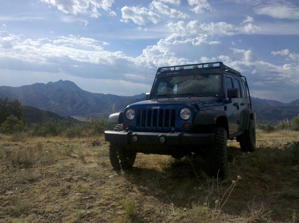

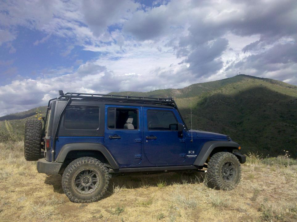

I had the kargo master congo cage on my 2dr. Tilts so you can remove the tops. A bit on the loud side. It mounted on the a-pillar and then had a brace that bolted to the rear side bumper bolts and followed the contour of the frame. There it pivoted right above the bumper. No drilling and affordable.
I'm leaning towards one of the Gobi racks for my 4dr..well made and sexy. Plus all the gnarly things you can add to it. Also a no drill rack and bolts on in the same spots as the Kargo master.

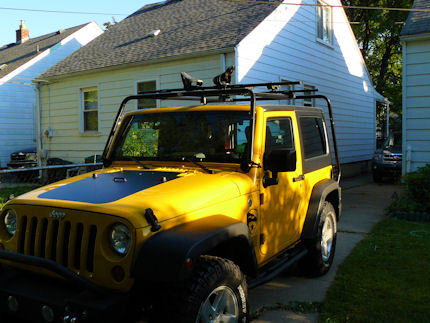

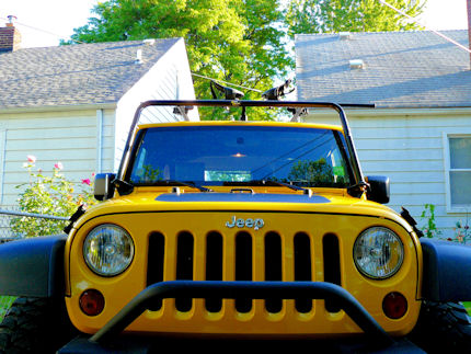

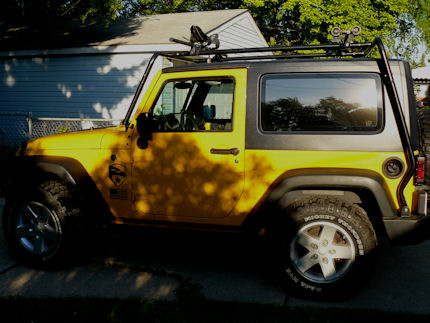

Hi heres the Kargo Master Rack mentioned in the last post . Ive had it on my 2008 JK for about a month or so . I use it to haul two kayaks around MI. so far its been fine not too noisy with the hard top on
freedom panels come off without tilting.
Couple precautions - make sure you have help to put it on and if you had pillar light mounts they wont work with the rack I had to buy some Warn mounts for my Rigids.
Is it as nice as a Gobi hell no but its also 1000.00 cheaper ( :

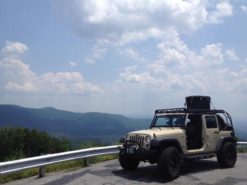

Went thrugh this the first month I had My Jeep. The Gobi Stealth rack is the superior rack. It is made better, and most importantly it creates the least amount of Drag. However, It is near impossible to take the roof off.
I bought the Body Armour Safari and Base Kit because I have a hard top and you can slide the hardtop off pretty easy. But it is so tall with 6 inch lights on the front and 5's on the back, it just murders MPG's and highway performance. Another issue with the Body Armour is it is soooooo F'ing hard to run the wires through the tiny holes in the pipes. But it will except Thule racks for your Kayak and is pretty strong. I will put up pics soon but me and my buddies went on a week long expo of forrestry roads and national forrest in GA and TN with at least 350lbs on top and it worked great!
Conclussion:
If you want to take on and off your hardtop get the BODY ARMOUR
If you only take off the freedom panels spend the extra 500 and get the Stealth GOBI! (Still kinda wish I had)
