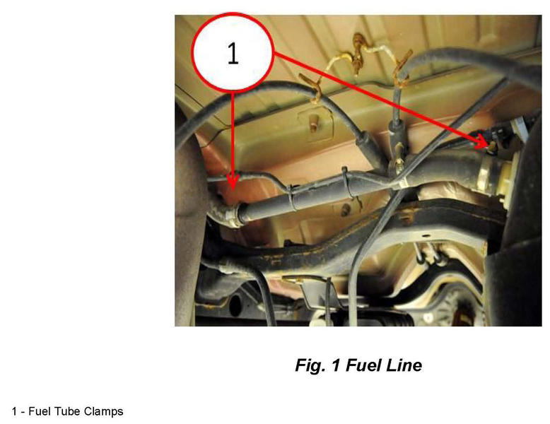

This is information from the service bulletin on the 2008 JK.
PARTS REQUIRED:
REPAIR PROCEDURE:
1. Open Hood.
2. Disconnect and isolate negative battery cable.
3. Remove fuel cap.
4. Hoist vehicle.
5. Cut the tie straps holding the recovery line to the fuel tube.
6. Remove the fuel tube and discard (Fig. 1).
7. Install the fuel tube (CNNNX321ac) and torque clamps to 3 Nm (30 in.lbs).
8. Tie strap (06016076) recovery line to fuel tube in two places (Fig. 1).
POLICY:
Reimbursable within the provisions of the warranty.
Again this is from the 2008 service bulletin.
