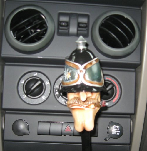

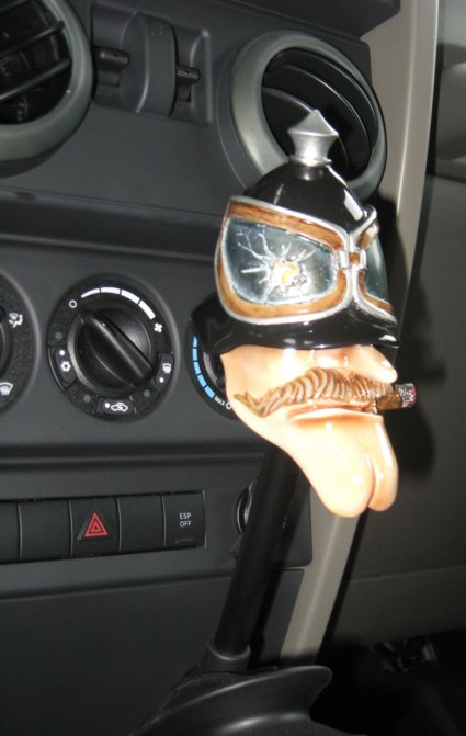

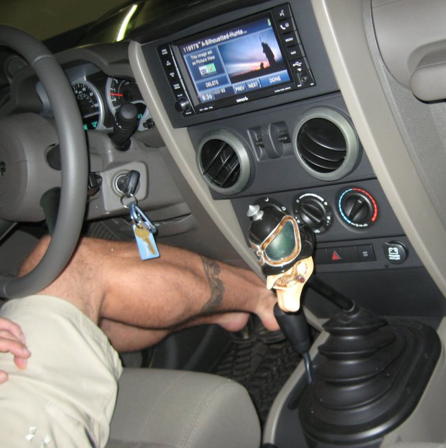

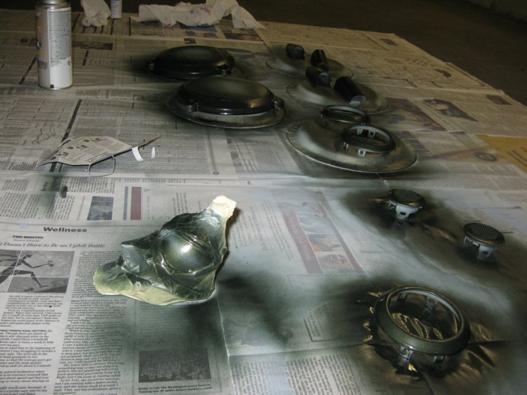

Default Custom Shift Knob
I placed a towel around the shaft, then attached a channel wrench just under the shift knob, then hit it gently with a rubber mallet...... and it popped right off -- no problem.
Then I had to drill a hole in the bottom of that custom knob. hole was a hair over 1/2" wide and I made it it 1.5" inches deep. fit very tightly on.
I also painted the lenses green to match the exterior.
