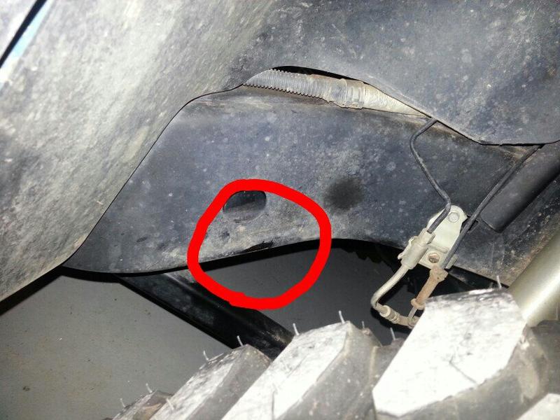

Having re read my posts I am a bit unclear sorry.
The front tyres are rubbing both sides when on full lock turning. This rubbing is on the chassis.
As I said earlier as the lift is small I dont want to bump stop much more.
I have attached a pic.
Thanks all for your comments

Originally Posted by Scruff
...The front tyres are rubbing both sides when on full lock turning...
Follow the procedure at the website I posted earlier so your steering wheel is slightly more limited and you should be fine.

If it is only that much rub when wheeling I would leave it alone and not even worry about it.

Thanks guys. I also noticed that slight rub on the road when at lock so ill try limiting the steering.

Did the steer stop adjustment and seems to have solved it. Thanks all for the tips
