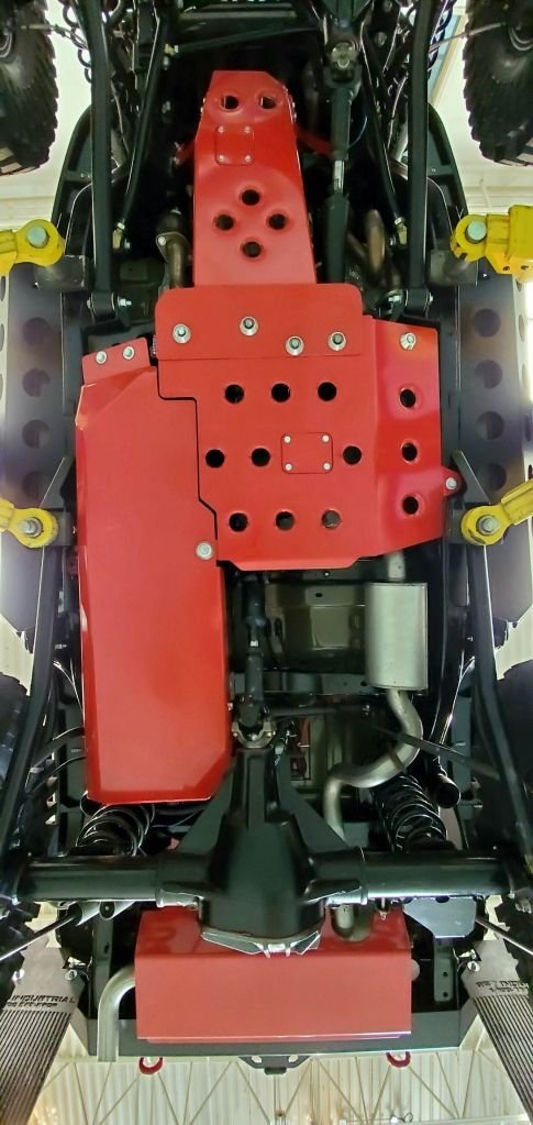

I think you’ll find decent skid plates pretty expensive.
i shopped around and finally opted for a custom set - slightly more expensive, but exactly what I wanted ....
Neville

What Dirtman said - remember every pound you add has to have to be hauled somewhere and that costs power and economy.
Creepy, that is a nice set of plates. They get made in the Lower Mainland? I am not going to replace the factory gas tank one but will make my own for the tranny, TC and Engine as that Chev sump is a dinky little thing all sitting out on its own. More worried about it being hit by a log or similar getting flicked up.

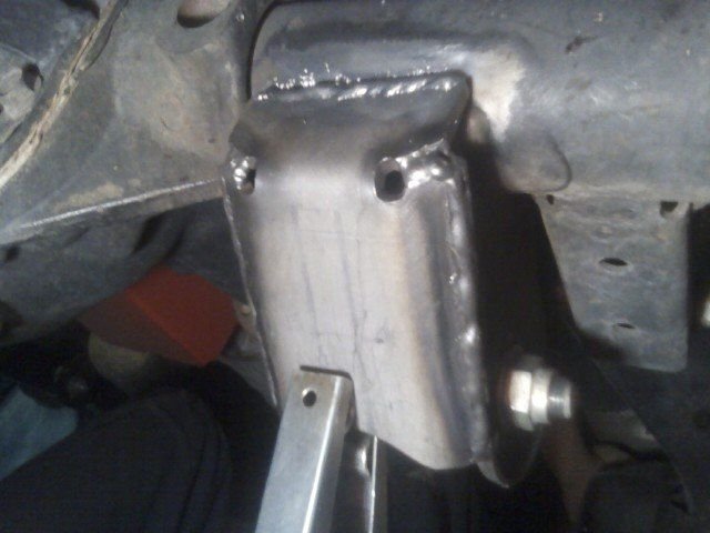

Front LCA skids above, rear LCA skids below. Hardly any weight, significant labor.

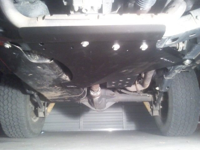

Rancho oil pan skid. Tight fit over the stock pan, only adds a few pounds. Can't interfere with anything or restrict air flow. Cheap insurance for an unlikely, but potentially catastrophic hit to the sheet metal oil pan.
Rubicon Express TCase skid. It also reinforces most of the crossmember and adds some protection to the exhaust crossover. It's accumulated some minor rock rash over the years and hasn't bent. There's an Evap skid visible toward the rear that's never hit anything. Guessing about 40 pounds over stock.

Yep, Taran and the boys at BCC working their magic !
Neville
