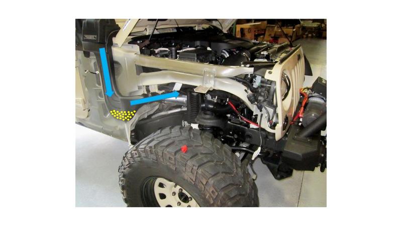

Pre-filters aren't all born the same, and so are snorkels. Some function better than others. A well-designed snorkel does a good job at blocking sand before the air filter, but a well designed pre-filter would still be an improvement, especially for the finer dust.
When a snorkel has a "sink", either water or dust are trapped in it. If it doesn't have it, then a pre-filter would do the vast majority of the job.
Name:	Rugged Ridge Snorkel - flow - JPEG.jpg
Attachment 592101
