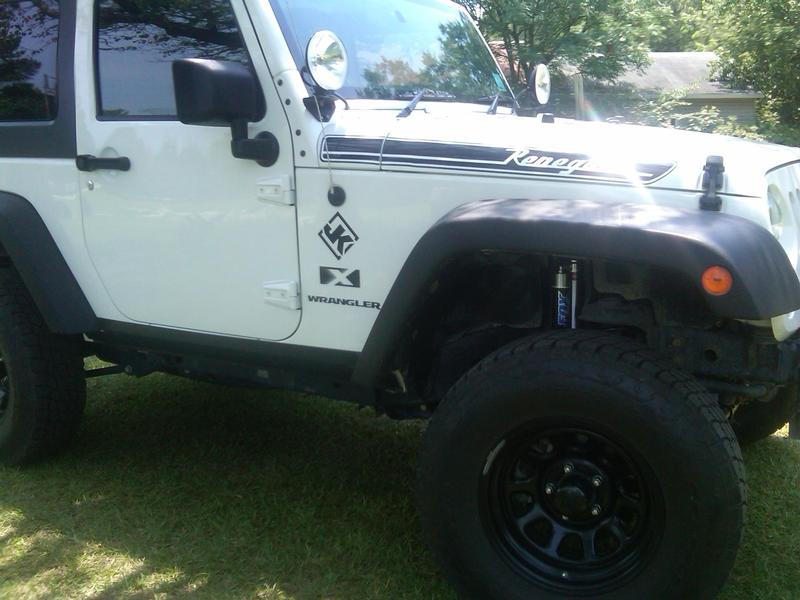

I just put this lift on without adding control arms. Many people run the kit only without changing CA's. I'll go with lower CA's first if the need develops. I would suggest going with high end shocks since it is your DD. I got the Fox racing piggy back reservoirs in the front and the 2.0 fox shocks in the back. The ride with these shocks is much better than other shocks which I consider important on a DD.

From what i have read the ride is pretty good when using the shock adapters with the rubicon shocks. Either way, i can try it with the rubi shocks and then go from there. I dont see the need to jump into crazy shocks just quite yet. I know that Bilstein 5100s are in my future in sure but for now my research has shown the Rubi shocks should be just fine. As for the CAs, i think i might go with front lowers to start and go from there.
