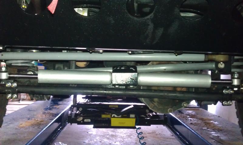

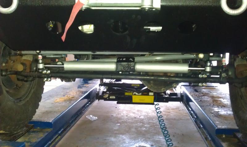

I just put on the RC Dual and love it it really tightened up the steering!
I have a RE 4.5"Super Flex Lift running on 35" and had the stock stabilizer and it was just to much for that little stabilizer. The RC Stabilizer Kit works well for my rig.
