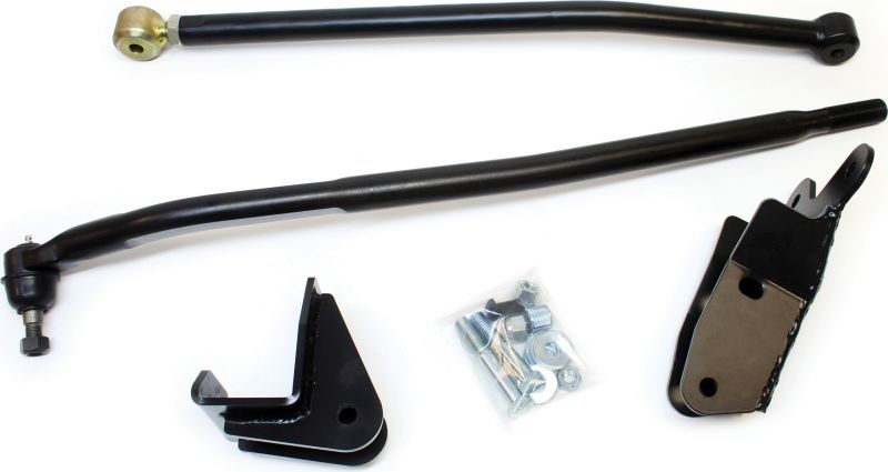

Yes, I installed an after market drop pitman arm which is for the 3"+ of lift. Teraflex has a drag link product that comes with a extended track bar bracket, please take a look.

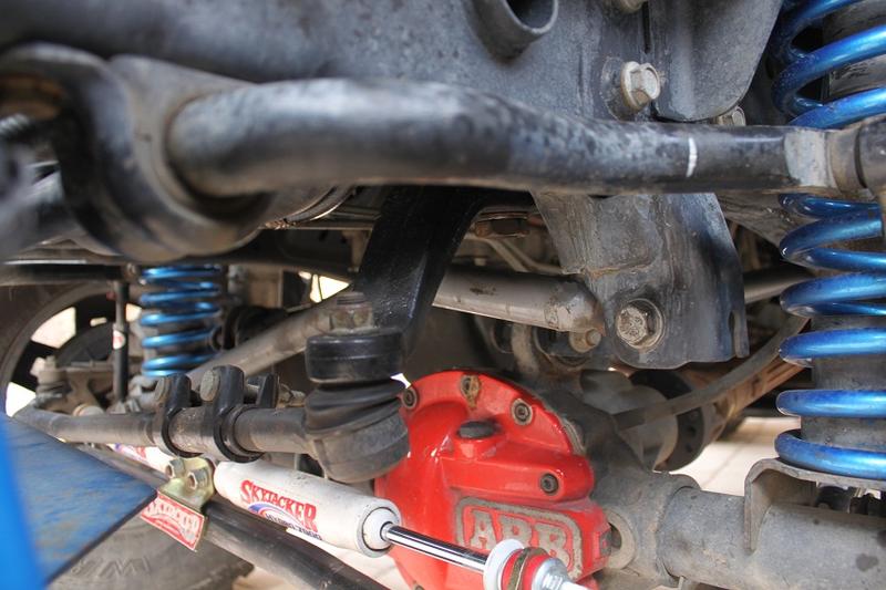

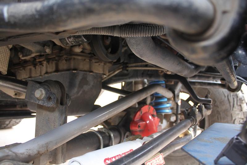

I took some pictures showing the front steering section setup, please take a look what is wrong with that. Thanks!
See if you can take a picture of the setup from up front dead on. Angle shots can be deceiving, but what you're looking for is to make sure that the trackbar and the drag link are parallel to each other.
Cant tell for sure, but from your 2nd pic, it does look like your trackbar and drag link are not parallel. It could be just the angle of the shot, which is why a front shot is preferred.
If you installed the extended drop pitman arm, then you do not want to also install a flip kit such as the TF pictured. It's either one or the other. If you keep the extended drop pitman arm then use the stock drag link or HD after market drag link non-flip or use the TF flip kit but put the stock pitman arm back on.
From what I can tell from these pics, I would just remove the after market drop pitman arm and put the stock one back on to get your geometry correct and parallel. That might be all it takes. Also from this pic, it doesn't look like you have enough lift to run the TF flip kit. It looks like there would not be enough "up travel". As mentioned get a front shot to get a better view.
