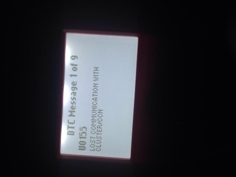

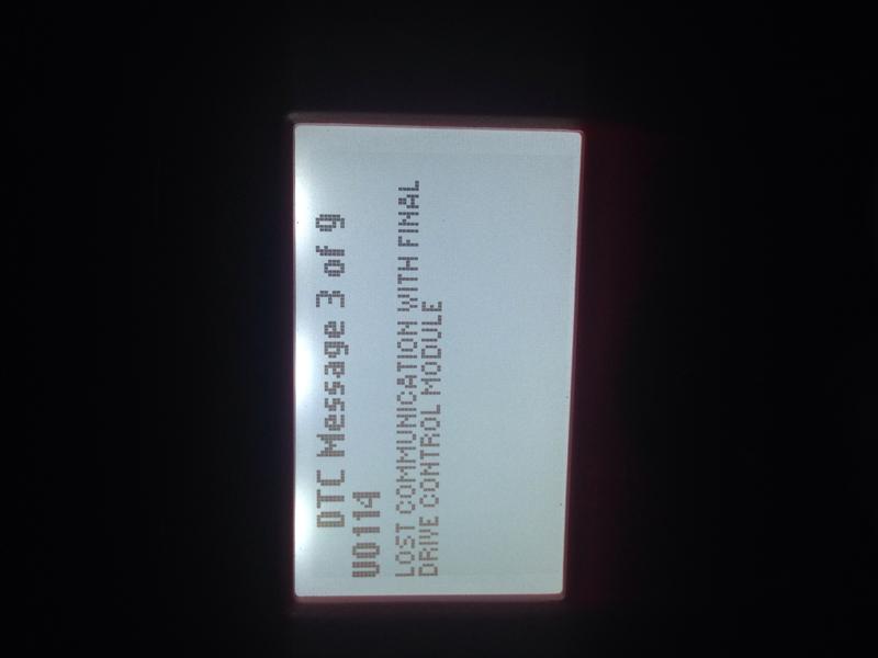

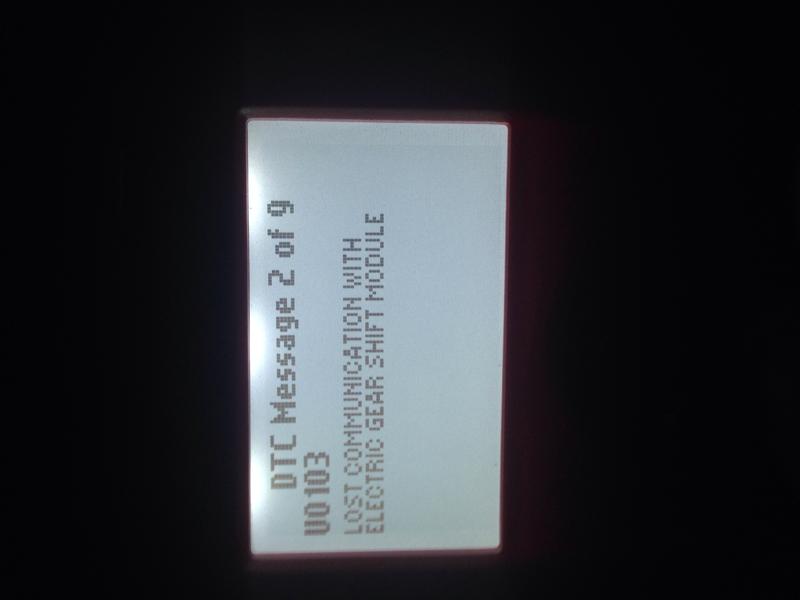

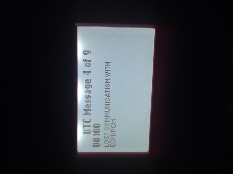

Here are a few of the codes I am getting.
Just to disclaim, I am posting this for people's knowledge/reference not to bash Superchips. I could not find any threads on superchips errors so I decided to document this here as I am sure I am not the only one who is/have had this issue.
