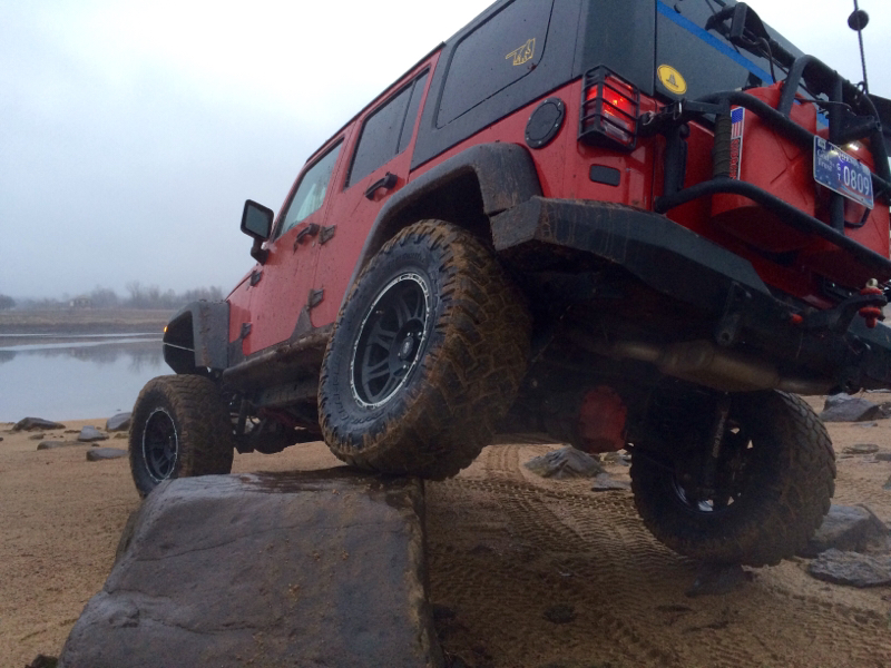

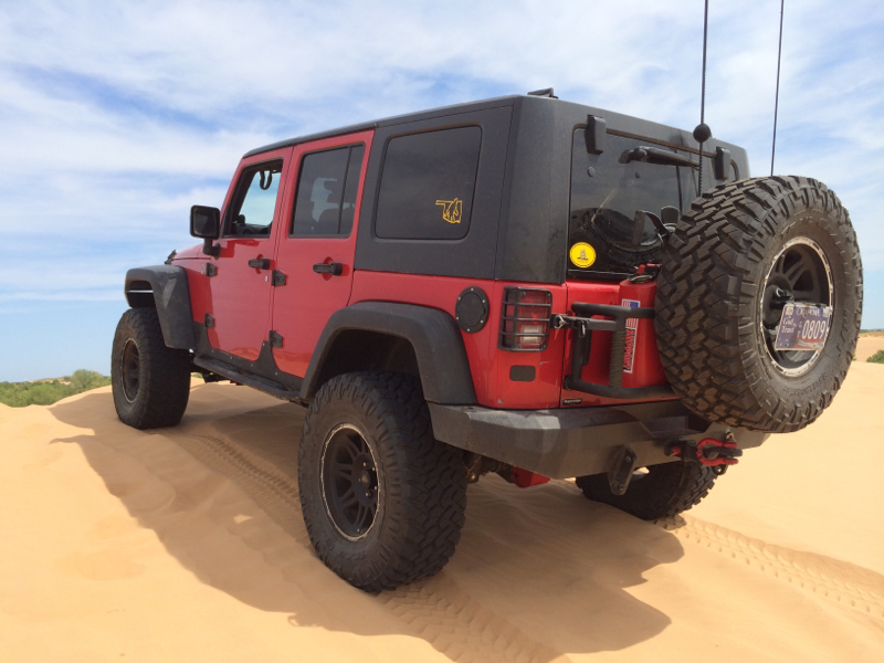

What Mark said ^^ also, my factory spare carrier cracked with the factory wheel and tire! They are junk. When mine broke, I couldn't afford a brand new aftermarket carrier so I just strapped the spare in the cargo area. Later, I got OR Fab's Swing-Away Tire Carrier with the Gerry can option. Installation was a PITA but I would probably do it again just because of how much I love the darned thing. Click image for larger version
Also, I think it looks pretty cool without the spare

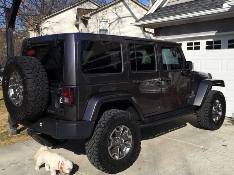

I'm partial to the TF carrier as it's pretty close to stock-OEM.

Old Sep 29, 2015 | 07:50 AM
rsmwrangler's Avatar
Joined: Jul 2015
Posts: 290
From: RSM, CA
Originally Posted by Eddie Man
Do this mod correctly and do 5th wheel carrier together with the 35" upgrade.
IMHO, Why risk damage by being hasty.
As for which carrier upgrade...
That's all a matter of preference.
Attachment 625846
Is it necessary to buy the extra adjustable tire mounting kit to fit a 33 or 35 tire with the standard TF carrrier? or that's mostly needed for a 37 ?
I have a 285/70/17 tire as a spare at the moment , 58lbs tire + 25lbs on the wheel, so that should be 83lbs mounted in the stock carrier, nothing is rattling at the moment, and nothing has cracked in 3 months since the change, but if people have broken the carrier with stock spare (i'm assuming Sahara/Rubicon, i think with the Sahara wheels/tire the weight is 72lbs for the spare carrier,i i figured 10lbs more wouldn't hurt), makes me wonder whether or not to make the investment, damn it this was another reason for me not do to 35's
