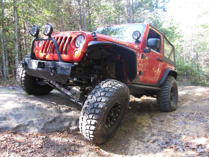

ID:	93735Click image for larger version
ID:	93734Finally had a chance to test out my trailmaster lift. Never could get it fully flexed out.
Im running 37s and 5.13 gears. Also have a 1"BL which will probably come off now that Ive got the Trailmaster.
