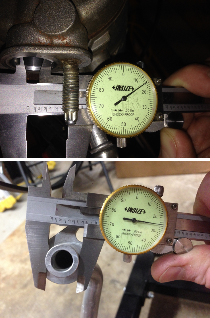

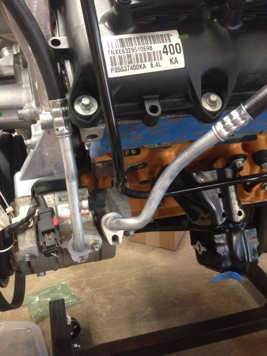

Have any of you all had problems fitting the JSS rear AC hose onto the compressor? Looks like my hose adapter is about 10 thousandths too big? I asked Todd and he apparently hasn't had this problem before. I'm using the Ram 1500 compressor, part number 55111442AG from a 2013 truck.

Sorry for the delay. From what I googled that compressor looks a little different than the one I used. I can't remember, but wasn't there a specific hose that JSS sends you? I can't remember which one it is.

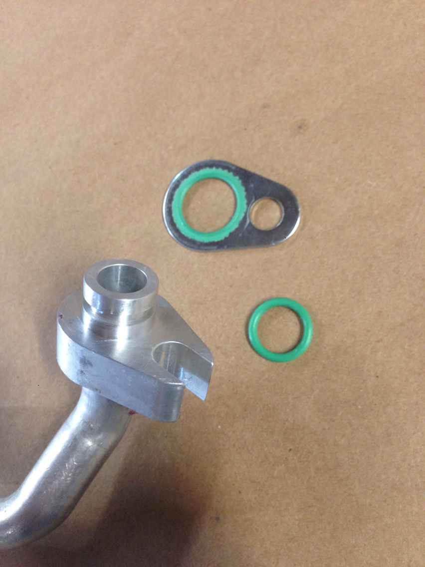

Thanks for replying. I went ahead and bought another ac compressor from either your parts list or da20captain's. Todd's return hose didn't fit that compressor either; so I lightly sanded about 10 mils off the diameter of the hose fitting and then used a piece of 3M scotch brite to smooth out the sanding marks.
So the ac compressor kit comes with two types of gaskets that may work. Did you use both of these on each of your hoses?
