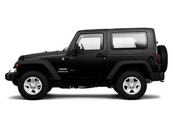

Thank you so much, here is a couple I have been thinking about, just to get some input. this is my jeep {basically} I like the Black wheels but think they would blend in to all the other black of the Jeep.

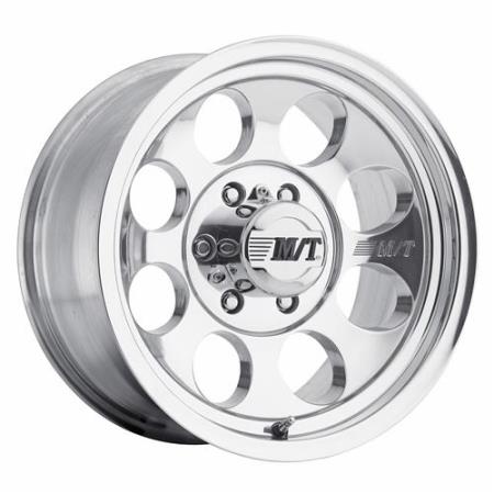

Classic III Polished Alloy Wheel
Technical Details
• Fits 2007 to 2015 JK Wrangler, Rubicon and Unlimited
• 2 and 4-door models
• Fits 1999 to 2015 Grand Cherokee
• Wheel Size: 17x9
• Bolt Pattern: 5 on 5
• Backspace: 4.5
• Max Load: 2500
• Offset: -12
• Finish: Polished

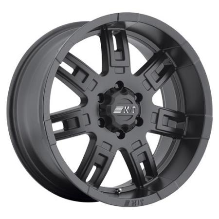

Sidebiter II, 17x9 with 5 on 5 Bolt Pattern - Satin Black
Technical Details
2 and 4-door models
Wheel Size: 17x9
Backspace: 4.5
Max Load: 2600
Offset: 0
Finish: Satin Black

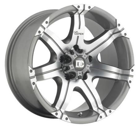

Dick Cepek
GUN METAL 7, 17x9 with 5 on 5 Bolt Pattern - Gun metal gray metallic
Technical Details
2 and 4-door models
Wheel Size: 17x9
Backspace: 4.5
Max Load: 2500
Offset: -13
Finish: Gun metal gray metallic

Those all work. I agree about the black on black. Gun metal or a brushed alloy would look good. Not a fan of polished as it looks like chrome.

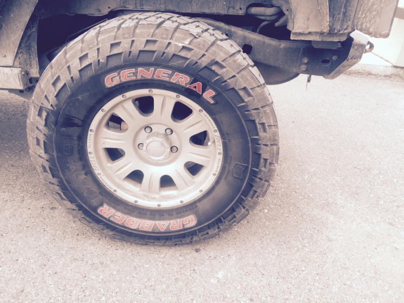

OP this is what I run on pretty much the same jeep as yours it's the eagle alloy series140 polished, these haven't been polished in idk how long though lol
