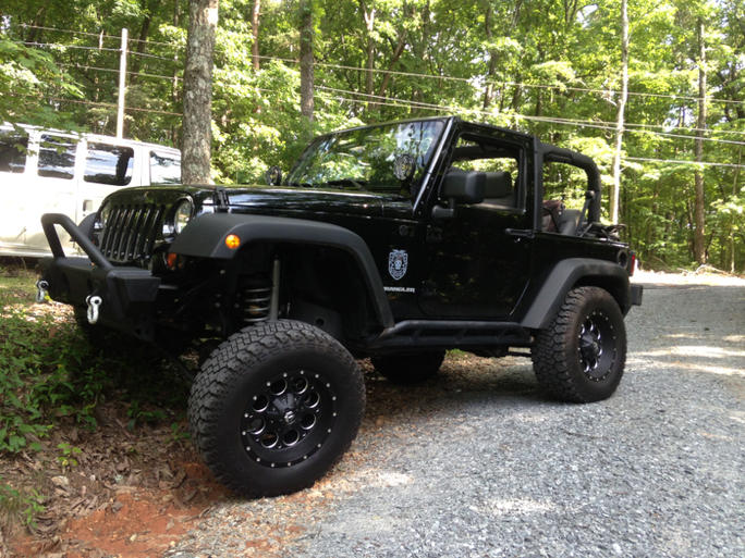

Has anyone heard anything about the rubicon express 2.5 with the monotube shocks? It looks like it's a half decent kit and people seem to like the monotube shocks.
Old Jul 18, 2013 | 01:26 PM
  #46
One bad black JK's Avatar
Joined: Apr 2013
Posts: 161
From: Ga
I'm running this lift on my 2010. I love it! It flexes great and rides awesome! I would suggest you go ahead and get front disconnects and a front track bar. I went with jks and am very pleased.

I already have the electronic disconnect so it should work well. I haven't heard much about their lifts online. What size are your tires? Your rig looks awesome!
Old Jul 18, 2013 | 02:47 PM
  #48
Joined: Apr 2013
Posts: 161
From: Ga
Thanks! I am running 33's right now. I want to go 35's but don't really need the 1" you gain and all the power I would loose haha!
