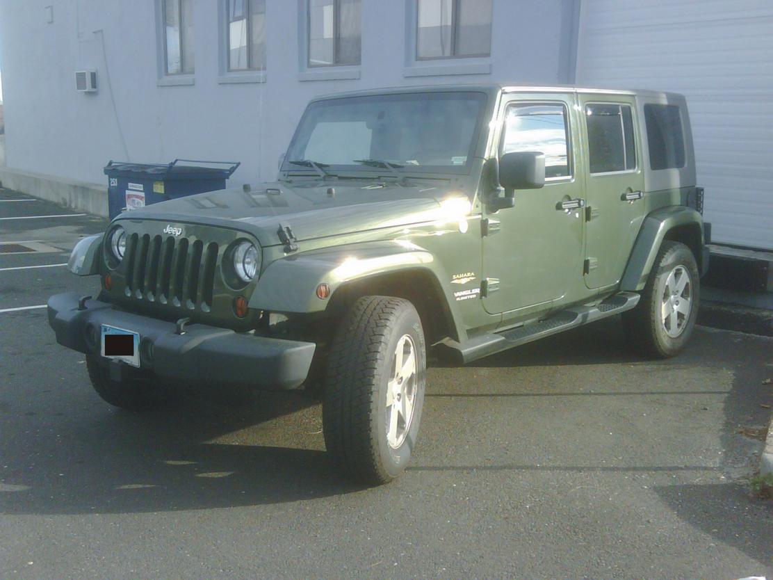

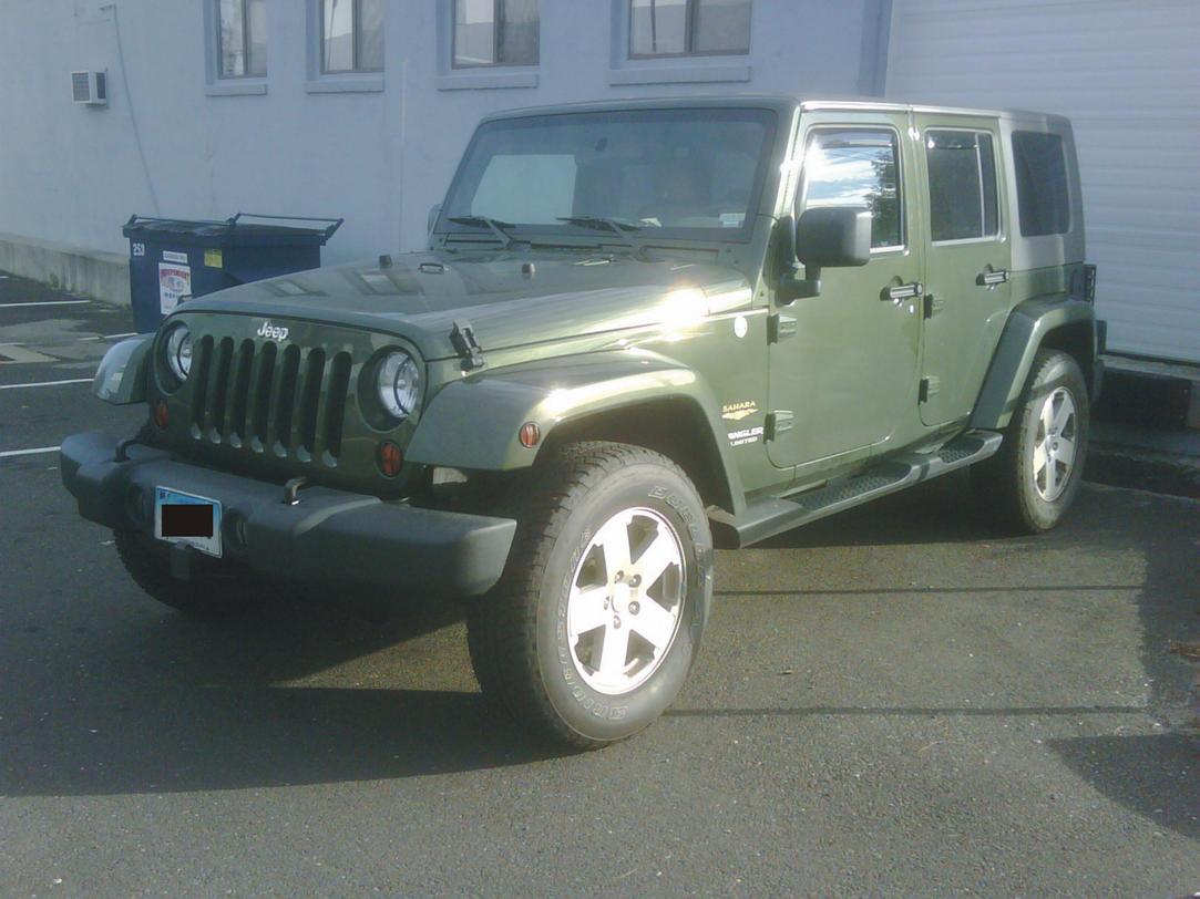

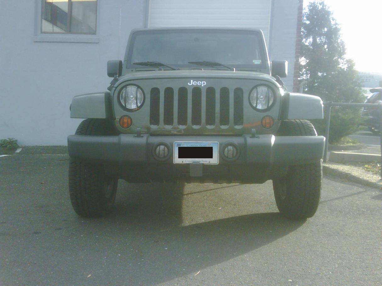

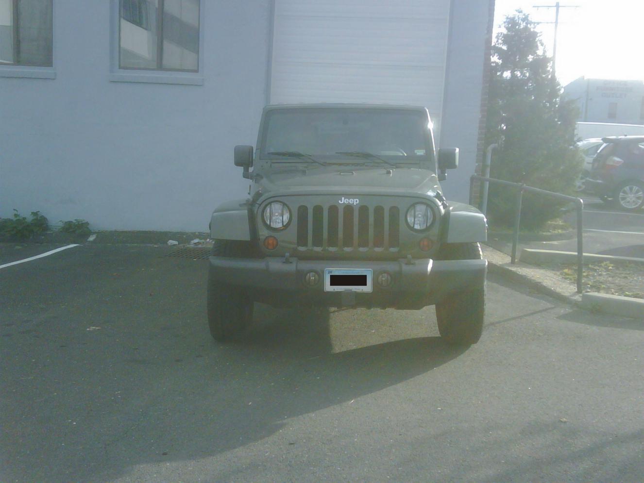

Just took these with my phone.
I don't think it looks any different unless you're looking dead on. I guess any racoons in the road might think "wow - that looks cool!" just before they get squashed.
Like I said, it won't hurt anything. I installed them because:
1) You need to when you use the leveling kit (clearance for the sway bar links).
2) I can now put cable chains on when it snows.
3) I plan to get bigger wheels anyway, and I'll need them then.
Hope that helps.
Jack

Sorry - I guess I DON"T know how to post a pic.
Try it this way.
