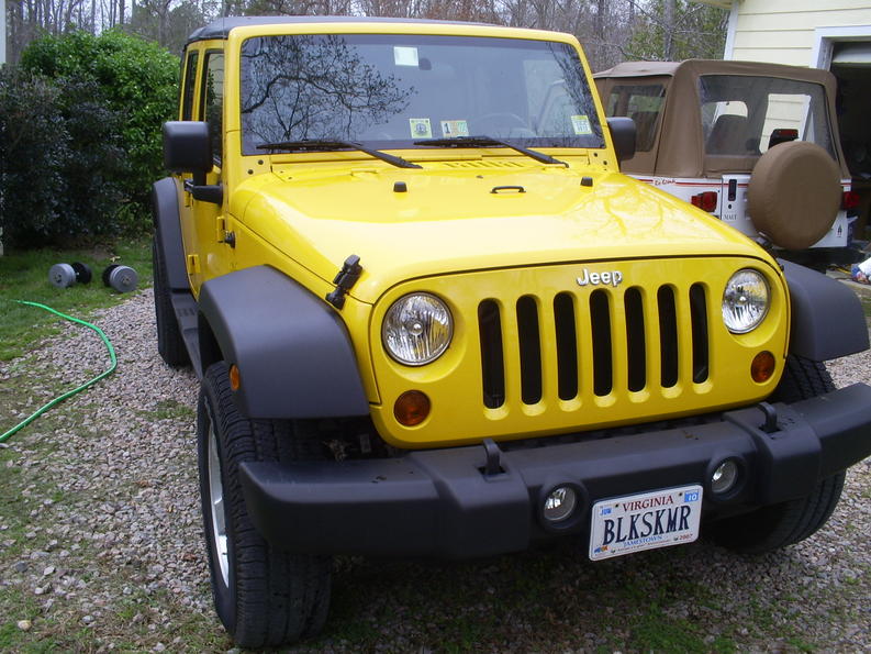

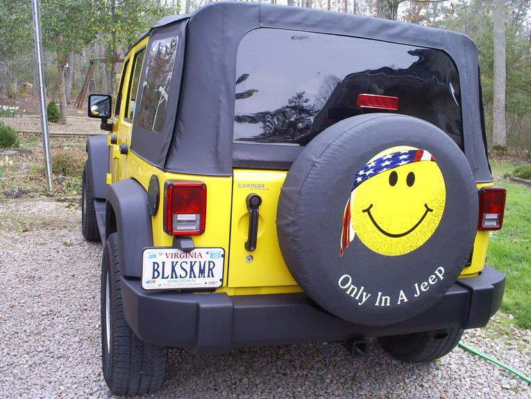

I'm a professional auto repairman, I've run 1.5 '' spacers for almost 2 years on my Unlimited. NO ISSUES. I used red threadlocket on the inner studs and cranked 'em tight. No torque wrench, no breaker bar, etc. Just common sense tightening. I've NEVER retorqued them, the threadlocker will not let them back off. However you can remove the wheels for flat repair, maintenance, etc even though threadlocker is applied, NO heat is required. I didn't redo the threadlocker when I installed new tires, believe me the stuff grabs the second time around just fine. A 1.5'' spacer will cause no bearing problems, the bearings don't know the difference between an offset wheel and a wheel spacer. Your JK will feel much more stable in turns and lane changes, after all the track will be 3'' wider....Your alignment won't be affected and the tire sidewall will be even with the flare edge. You will LIKE the spacers, they really make the JK look better. Yes you can retorque the spacers every tire rotation but from my own experience it's not necessary. You will hear 50 different opinions, look at all of them and make decisions that are good for YOU....Best of luck!!!
