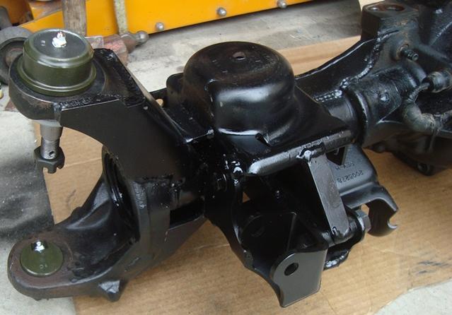

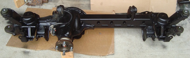

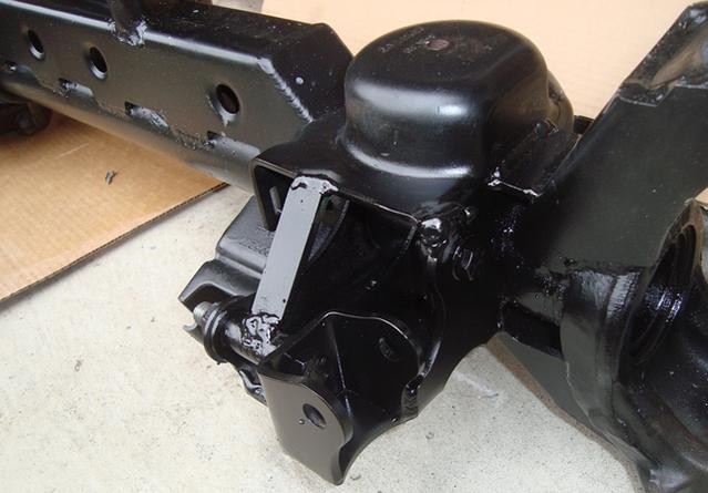

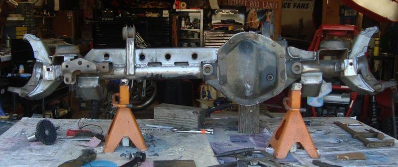

Originally Posted by JK08MCS
Shrinking the ID of those axle tubes always made me cringe with flexing and the play in the components.
Gosh, this sounds like a lot of fun with work.
It was a lot of fun/work the end result was worth it also after trussing/C's I didn't see the benefit to sleeve it
Name:	Dana 44 truss 5 cmp.jpg
Name:	driver shock mount cmp.jpg
Name:	pass shock mount cmp.jpg
Name:	Rubi 44 trussed_C_ shock mounts_cmp.jpg
So now I have a Rubi Dana 44 E locker 5:13 gears,Poly ball joints, Nemisis lower shock moounts and it's as strong as a 44 can be I also installed new Ujoints(spot welded the caps) in the axle and when funds are available I'll put in alloy axles with full circle clips
