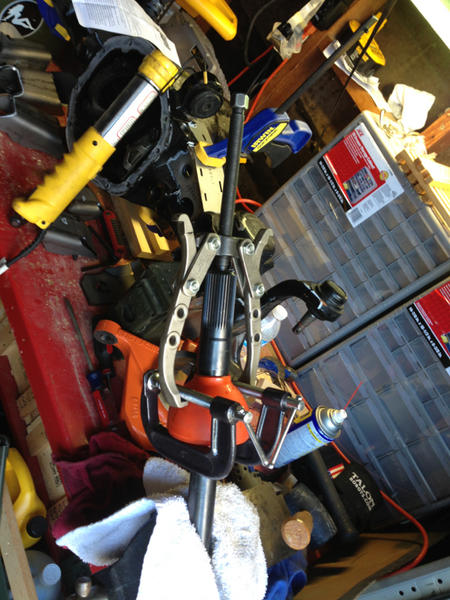

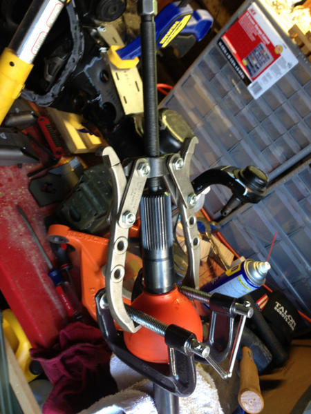

RCV shafts showed up with boots on and couldn't come off. Talked to northridge and rcv and the only plan was to hit both sides to get them off.
This is my plan and it worked with some wd40 and my strong hand!
