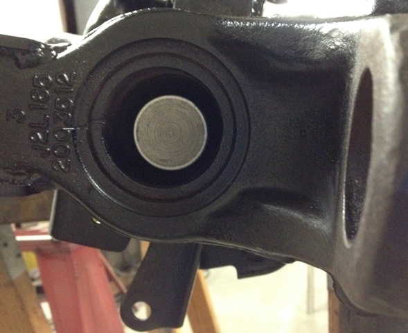

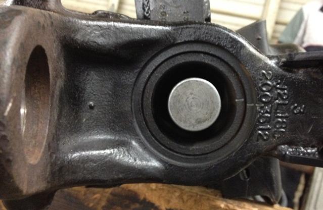

It also takes a different type of welding wire as I recall otherwise the casting can crack. I had a buddy weld my Jeep backbone brace on my Rubi dana 44 and even being careful moving the heat around and not welding in one spot too much the housing bent I had to take it to Bob Meyer Engineering in El Cajon to have it straightened. If I had to do it again I'd take it to him first and have him weld it up. He knows what needs to be done and not screw up your housing. Also note while I was at it I re-indexed the "C's" so I can have both drive angle and castor correct
Name:	Jeep Feb 2012 014 driver index cmp.jpg
Name:	Jeep Feb 2012 009 pass index cmp.jpg
