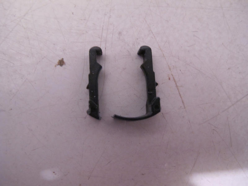

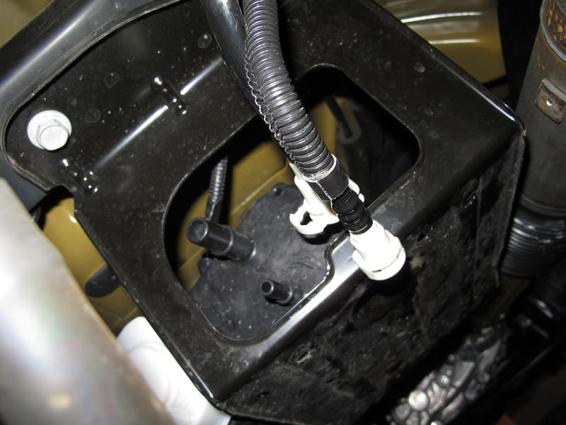

Originally Posted by bbolander
i knew if i were going to have problems it would be getting the wiring and tube connectors off of the evap cannister. the ps instructions are written for the earlier jk's, and the 2012's are different.
the electrical wire connector has a flat folded tab on the driveshaft side. i put a flat screwdriver in the fold, twisted it to open the clip on the cannister end and it came of easily. it seems like all wiring connectors on the jk have a locking tab of some sort and this one does.
next i put a flat screwdriver at the base of the rubber hose connector and pushed it up into the rubber some, wiggled it and it came off pretty easily. it wouldn't just pull off without doing that. it was probably easy since my jk is only two months old.
the 2012 cannister has two white plastic tube connectors on the driveshaft side. took a while to figure out how to disconnect them. they're very hard to get to so after struggling on the large one, i undid the bolt underneath the stock skid that bolts into the evap cannister so i could slide the cannister back and get better access to them. they have plastic c-clamps that hold the connectors on the cannister behind the boss on the cannister connections. i broke the small one trying to get it off, went to the dealer to order one and as you'd expect, you have to buy the whole tube for around $70 just to get the connector. so i decided to try making it work without buying a new tube. i think the trick is might be to use a small angle allen wrench to push the ends of the c clamp down and out to unhook them, after they're unhooked you can use a flat screwdriver or your fingers to pull them out. here are the connector pictures including the broken one for the smaller connector at the botttom:
Attachment 244595Attachment 244584
Just installed mine today, and broke the same small clip... I thought it was actually a pain in the a** to install on my 2012 being that the instructions were not for the 2012's and I installed the Canister into the Skid before installing the Skid to the Jeep making it nearly impossible to tighten the two front mounting bolts.
