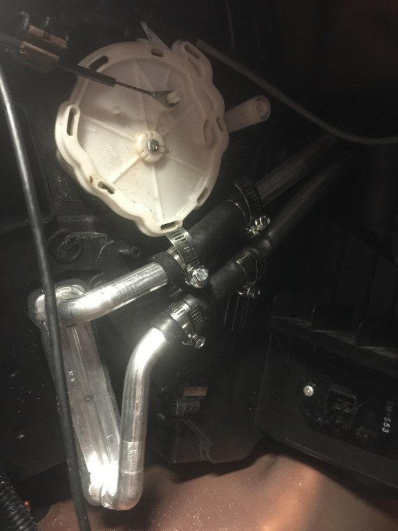

QUOTE=B. Law;4237246]Assuming it's the actual core and not related to the lines in the firewall. My second heater core failed about a month ago and not wanting to pull the dash and all other bits for a third time I looked for an alternative route.
It turns out the dash doesn't have to be removed if you don't mind a little bit of cutting. Part of the dash 'cage' will need cut at the heater core to your speaker pod. I've not noticed and adverse effects with this piece now being gone and the glove box still functions properly. The best part is, super quick core changes on future failures!
Here's a few pics.
The bit that needs cut out.
Attachment 654191
An oscillating tool made cutting the lines eay.
Attachment 654192
Tubes on new core cut and ready to slide in.
Attachment 654195Attachment 654194
Hose spliced in and ready to refill and test.
Attachment 654196
Not all this had to be removed, but I was planning to do a super clean of the inside after the core replacement. You'll be able to get by with just removing the glove box, the square snap in panel below it and the hand full of screw around it. A bungee or small ratchet strap will help hold things out of the way while you operate.
Attachment 654193

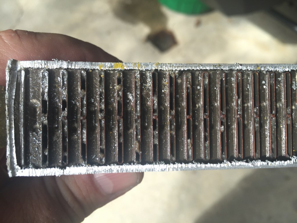

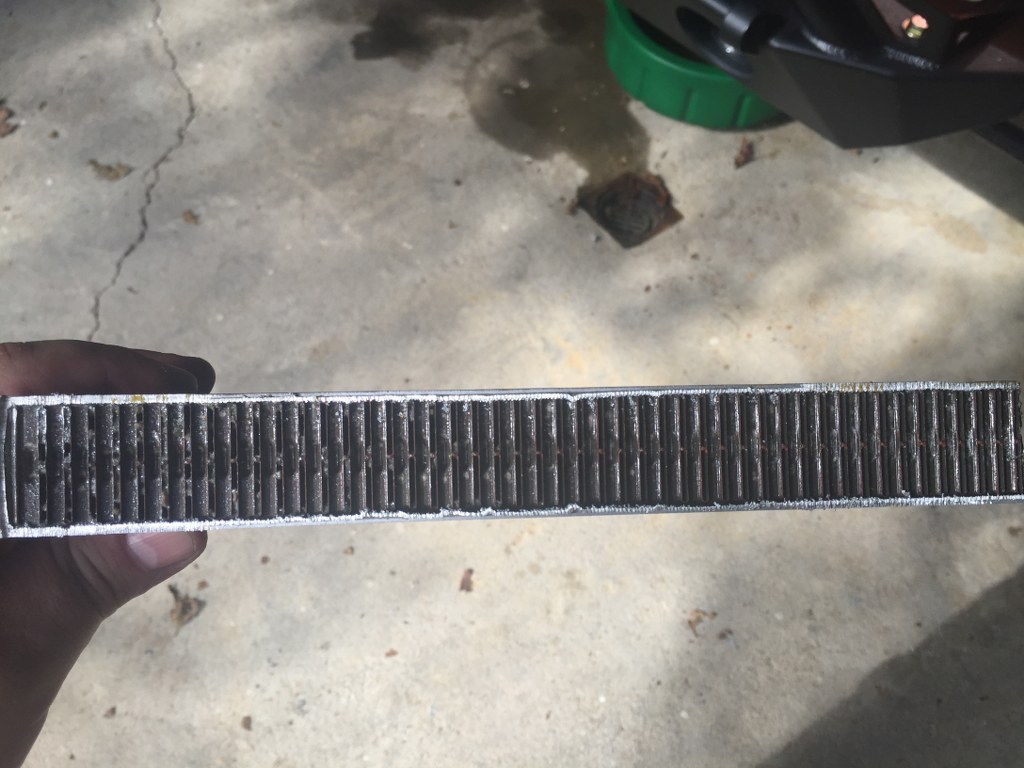

On to the old core. Like the others, passenger side was clean and clear whilst the driver side was clogged with crap.
Attachment 654200Attachment 654199Attachment 654198Attachment 654197Attachment 654201
That's all there is to it if you don't mind slicing a little. Removing the dash for a 3rd time was just too much for me, life's too short to give up another weekend.[/QUOTE]

From what I've read, it sounds like it's stuff carried by the coolant (particularly casting sand from the engine block) that's the problem, rather than defective heater cores.
Old Dec 8, 2018 | 02:32 PM
  #48
Rednroll's Avatar
Joined: Apr 2010
Posts: 4,468
Likes: 221
From: SE Michigan
As Mr.T mentioned, the failure is more about FCA's poor engine manufacturing process of their being casting sand left over in the engine block which eventually clogs up the heater core than the actual quality of the OEM heater core.
To avoid a re-occurrence it is best to install one of these filters into the HC inlet hose after replacing the heater core. Replacing the filter will be easier and more cost effective than replacing future heater cores.
