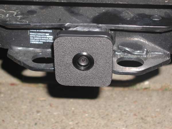

I have also heard of people getting a rubber hitch cover and drilling a hole in that to surface mount the camera to.
