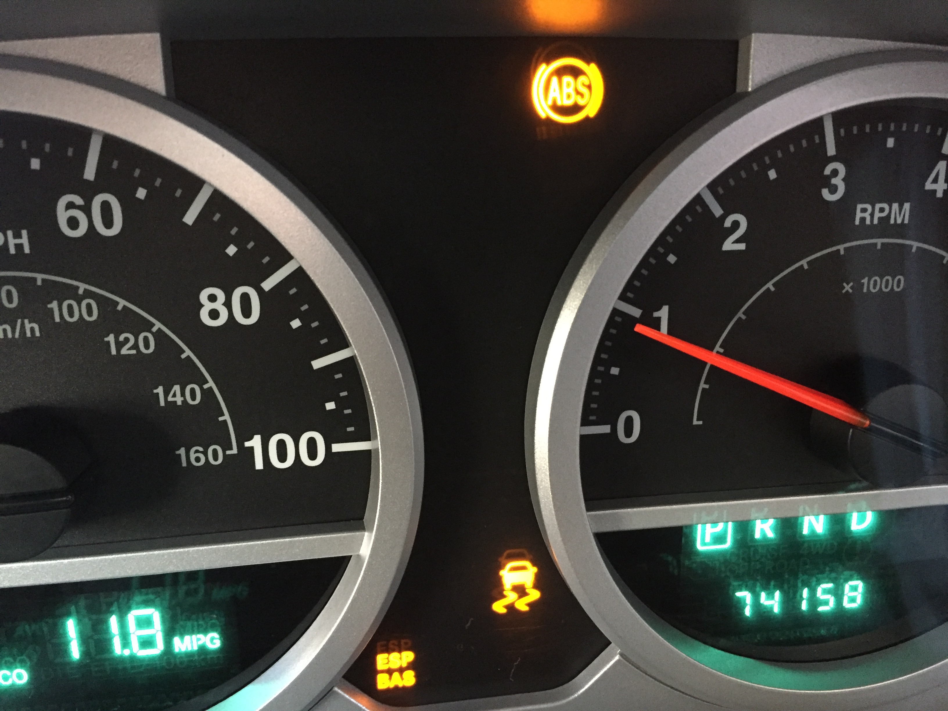

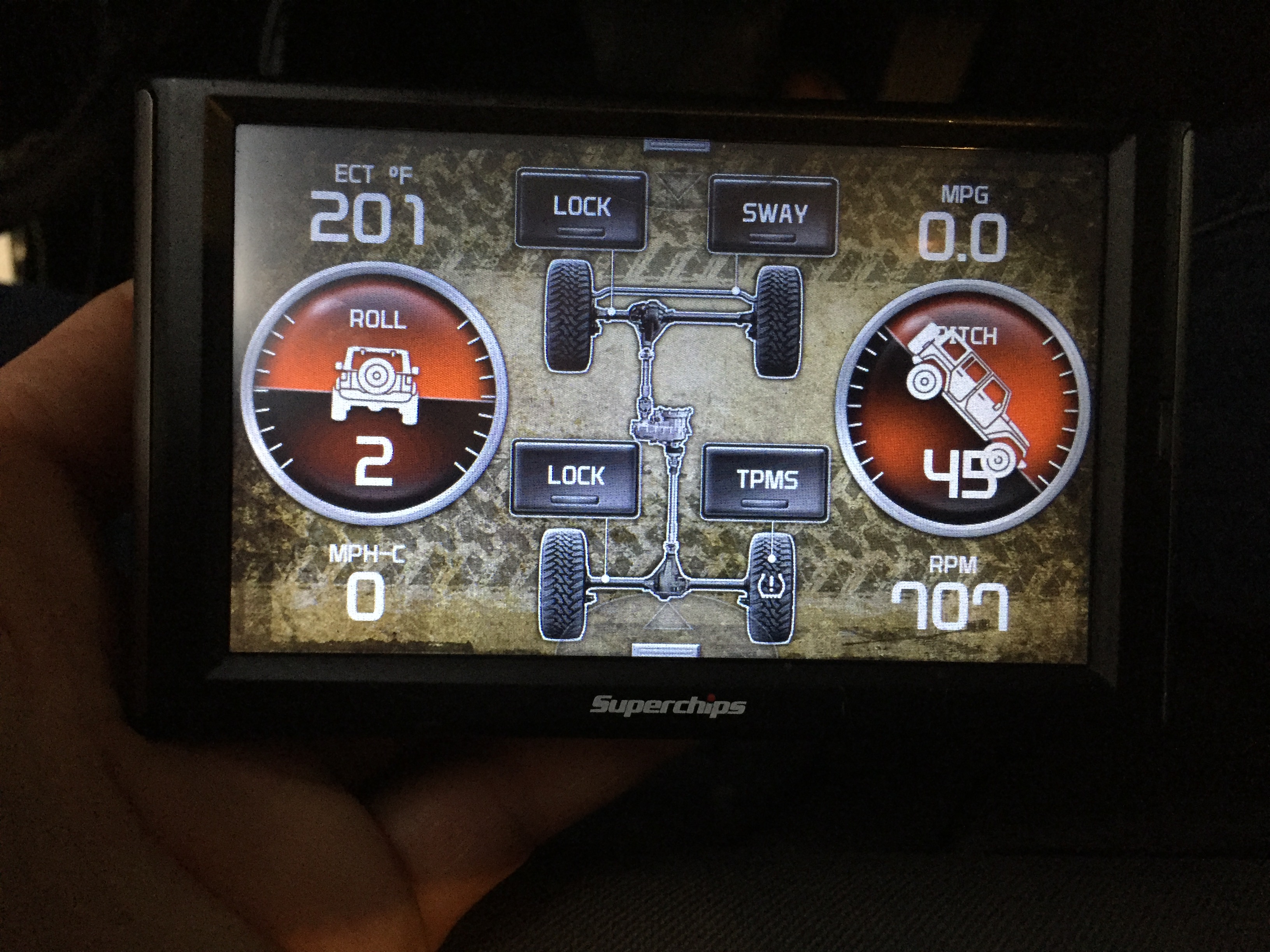

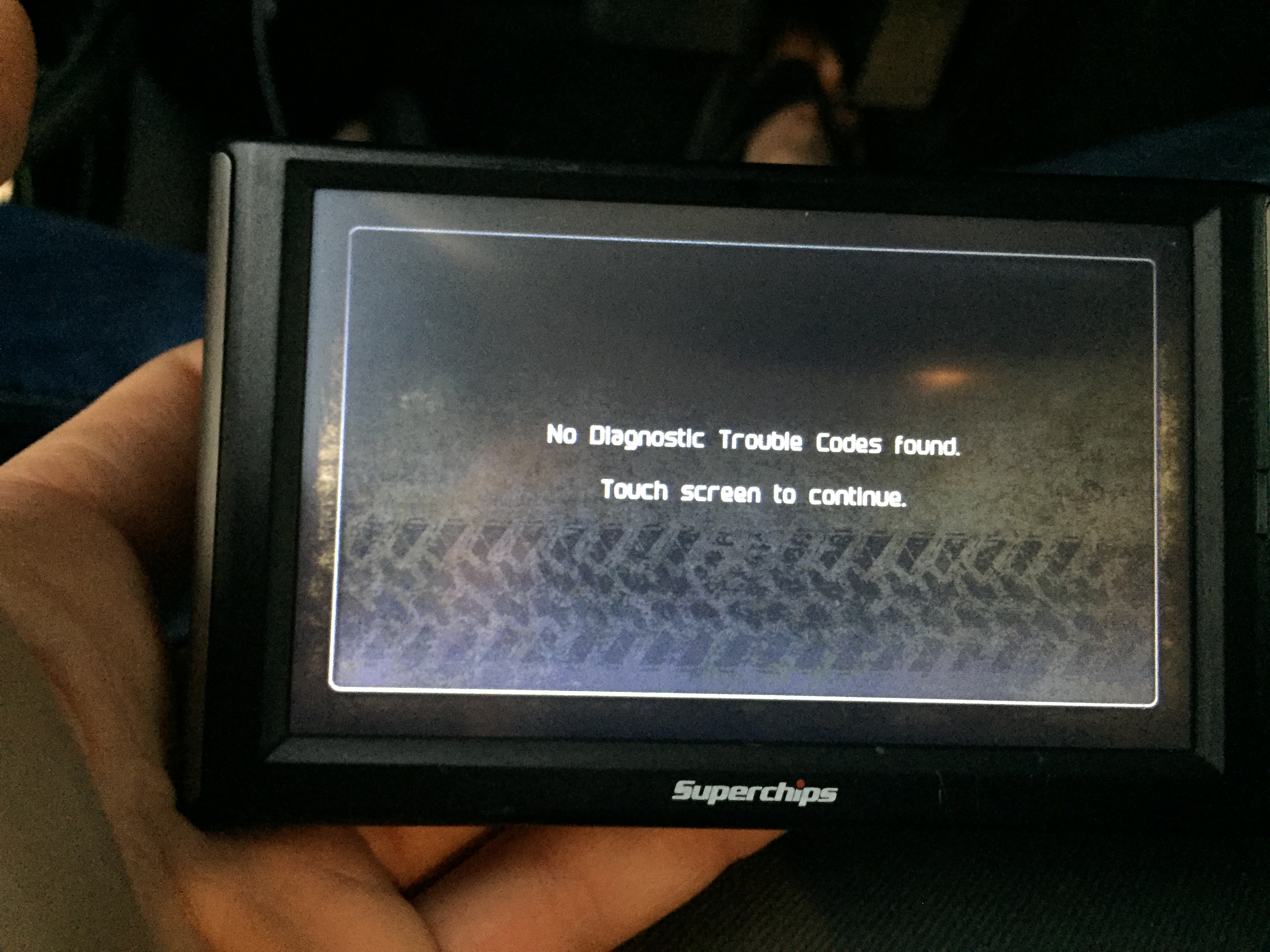

I have all three lights on. This started right after a car wash. Not sure it it is coincidence. I checked error codes on my speedchips, and it says NO Error codes, but it also says I am going down a steep incline. I was parked at a slight UP angle in my driveway when this pic was taken. Maybe it is a clue to what is wrong??? POsting pics of lights, and Speedchips feedback. This is a 2009 JKU, I am original owner, and I had all recall work completed. Clockspring was done about 2 months ago. Thanks in advance.

Bump this to the top for some help. I can go over to his place tonight and help him out.
Why is it not throwing a code? It seems like what happened to me when I had to replace drivers side rear wheel speed sensor.

So this original prob was due to Speed Control Sensor which was repaired at no cost since Jeep has issued a 15 year extended warranty for our front speed control sensors. Unfortunately I then got new tires, springs, shocks, and an alignment (supposedly) and the problem came back although a little different this time:
Starting a couple months ago, all lights would come on (less often now) but ABS would kick in EVERY time I was coming to a stop. It did not throw any hard codes. Took dealership 2 weeks to figure it out. Not complaining since they loaned me a new Cherokee. Anyway, they deduced that the cause was two fold...the previous shop did not do a proper alignment and the magnet on the speed control sensor was stuck primarily due to worn out hub and bearing. I did not mind their suggestion as I purchased a lifetime WRAP on my Jeep and it only cost me $100. That repair would have been over $700 otherwise.
It has been two weeks and the Jeep runs great so far. IMO Courtesy Jeep in San Juan Capistrano is the best service dept in this area. I won't share the bad experiences I had with other places. Courtesy is not perfect, but they genuinely care and try to fix your vehicle ASAP. My $0.02. I have to go to dealerships to have my warranty honored. If anyone wants to see my alignment report, PM me.
