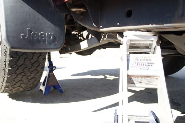

Loosen the lug nuts on the wheels you will be installing wheel spacers on, raise the car using your jack, then secure it with jack stands. Remove the wheels that are off the ground.
Figure 2. Raise and secure your Jeep.

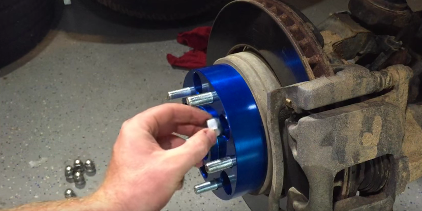

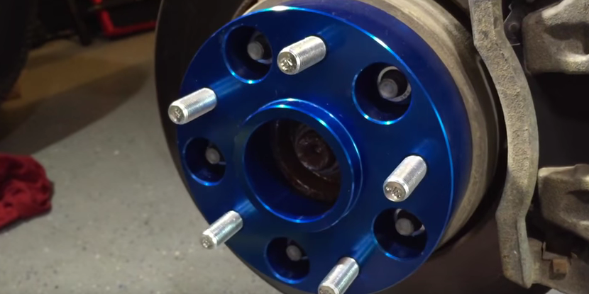

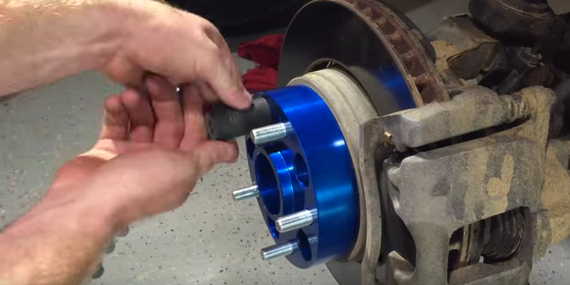

Step 2 – Install spacer
Install the wheel spacers, but don't use the factory lug nuts because you will use the lug nuts that came with it. Put the wheel spacer on the rotor's studs with its studs facing out. Install the lug nuts that came with it, with the rounded edge facing inside, towards the car. Use your socket to tighten them in a star fashion.
Figure 3. Align spacer.
Figure 4. Install lug nuts.
Figure 5. Tighten lug nuts.
Figure 6. Spacer installed.
