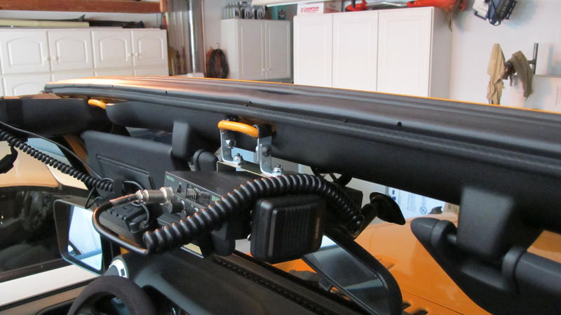

Originally Posted by bbolander
It's the center mount for a Misch overhead storage tray that I didn't end up using. Probably not worth buying the tray for $170 just for the mount! I've emailed Misch and suggested they sell these for cb mounts and they said they'd consider it. That was recent though, I don't know what they've done in that regard.
One thing I found that I just put on my Mopar sunbonnet last week and it's strap goes through the footman loop also. I was barely able to get the strap through the footman loop with my cb mount in place - just barely. The other things people have done with the hardware from the hardware store leave the footman loop more open for things like that.
When I removed my Mopar Sunbonnet yesterday the strap was really tight to pull through my Misch bracket mount, worried that doing that many times could fray the strap. So today I re-mounted mine the same way that USMC Wrangler did his. I bought 1" angle brackets from Ace, they look shorter than his. One thing to be careful of is that the straight side of the insulated wire loops must go on the outside of the footman loop or the spacing will be too short to match the slotted hoes in the CB bracket. This mount puts the CB closer to the windshield so the antenna cable has to turn tighter and it isn't as pretty as my Misch bracket was, but it's functionally better to be able to use the footman loop. Solid as a rock.

You can also see my ham remote head mounted with sticky back Velcro on the visor, perfect position for it and it's extremely lightweight.
<img src="https://www.jk-forum.com/forums/attachment.php?attachmentid=486455"/><img src="https://www.jk-forum.com/forums/attachment.php?attachmentid=486456"/><img src="https://www.jk-forum.com/forums/attachment.php?attachmentid=486457"/>
Looks good! Mine are 1" brackets too.
That's right about placement of the insulated loop brackets on the footman loop...flat edges to the outside. It is a tight turn for the antenna wire but I'm happy I didn't have to drill or cut any interior pieces.
