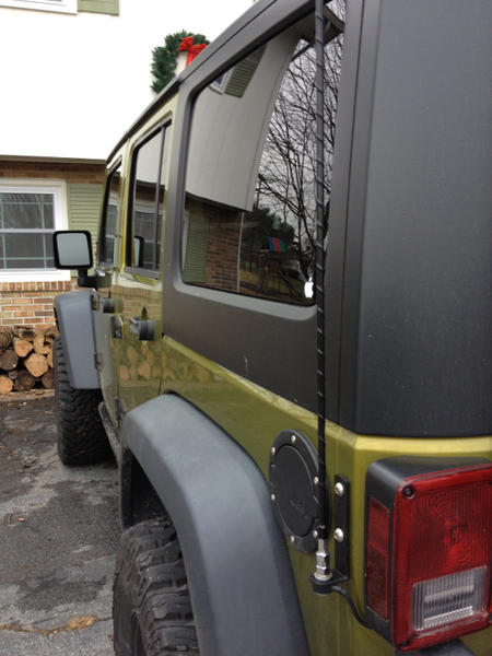

I made one and mounted my antenna on the rear corner of the tub. Granted I already had holes there from a wildboar roof rack but it worked nice and looks clean. I ran the cable right in behind my taillight.

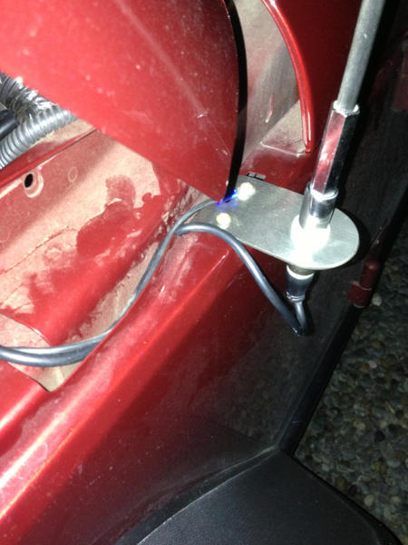

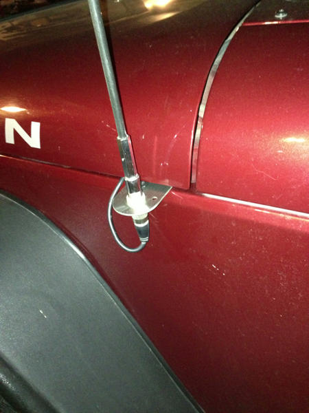

Got a flat mount and bent it in half at a 90 degree angle. Ran the coax through the hole that the rear washer line goes through. Looks clean, works great. Hope this helps. (Mount was $8.00 at the local Ranch and Home store)

Nice looking mount. Seems to be what the op was looking for
