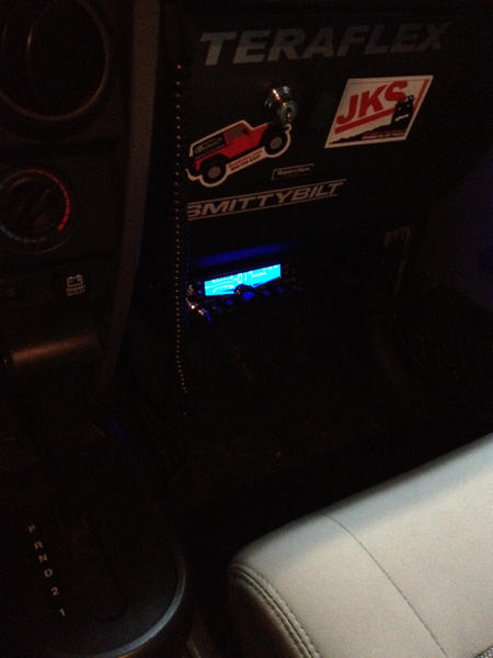

Originally Posted by TCJK11
I found a good spot!
X3, I like it!

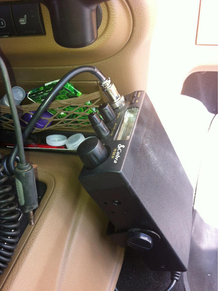

I mounted it on the passenger side and hung the mic off the side of the center console. The radio is small and does not get in the way.

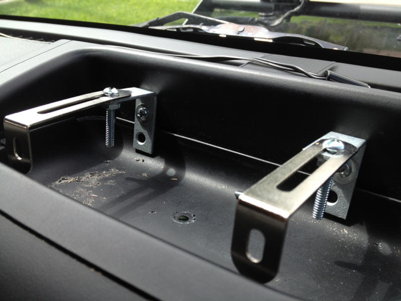

Just finished mine on my 2011... In the dash, had to fab a mount, the mount it came with wasn't deep enough to touch the bottom of the little cubby.
Did you make a whole mount from scratch or did you add some sort of extension to the current one. I'm thinking about doing the latter.
Polak potrafi!
I used the bracket it came with but used L brackets other metal pieces I had laying around...the dash holds the weight of the unit, while the brackets keeps it from moving around.

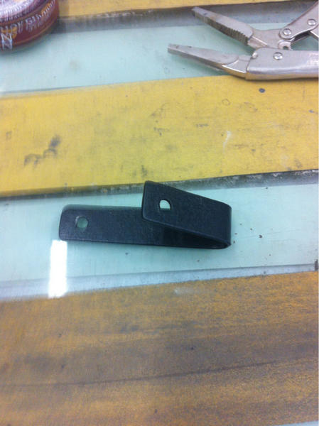

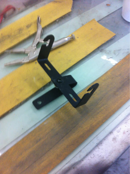

Thought I'd show this bracket I made so I didn't have to drill holes installing my Cobra 19. Under the plastic console there is a bolt you can use for mounting this bracket.

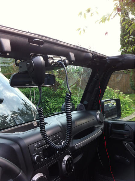

Followed the project-jk write up. Very clean and easy. Took about 45 minutes
Very nice. I was thinking about doing something like that. Now I know it is doable.
