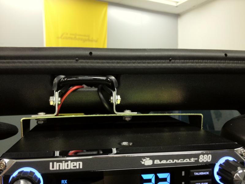

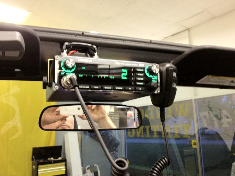

I have got to thank Rooster and the rest of you for the Footman loop idea. Worked great on my CB install yesterday on my 2012 with hardtop. Here are a few pics:
I drilled an offset hole so it slightly angles toward me.
http://www.flickr.com/photos/pjtocci/7990355737/
Relocated the 2A fuse:
http://www.flickr.com/photos/pjtocci/7990364288/
http://www.flickr.com/photos/pjtocci/7990355519/
Super low SWR on all channels
http://www.flickr.com/photos/pjtocci/7990184070/
I used an Arizona Rocky Road antenna mount. Worked out ok. They supply 6 fender washers for the base but I used two .5" locking washers - seemed to work better.
http://www.flickr.com/photos/pjtocci/7990364672/
I use a 4' Firestik II. Did not even need to tune it.
http://www.flickr.com/photos/pjtocci/7994473044/
There is a quick overview. Here is my album about the install on my Flickr account:
Cobra 29LX - a set on Flickr

Any other place to put the fuze?
Pain to change the fuze if anything happens.

Is the antenna on a spring? Seems like it will hit a lot of branches, drive through signs/overhangs etc. The firestik II ain't that flexible...

I was thinking the same thing. blue whip looks awesome tho. Patman, are you the same patman on KLR sites?
