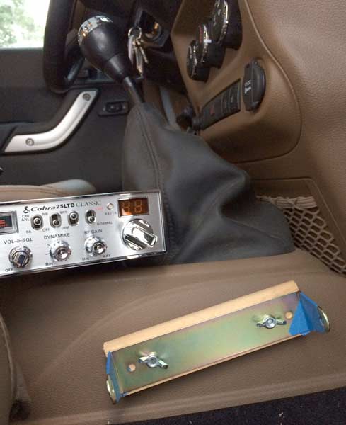

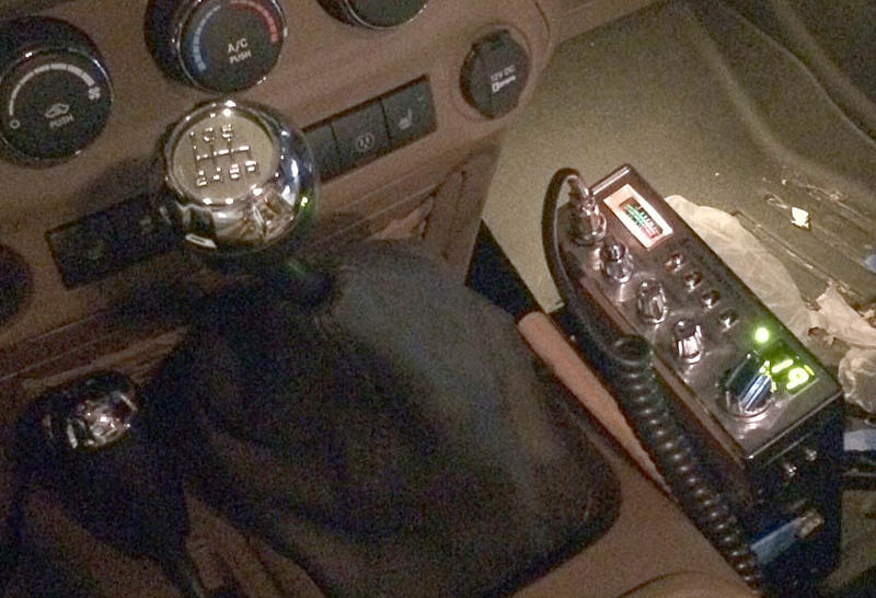

Posts: 364
From: Maine
I had mine mounted under the driver's seat with custom cables running to the channel display on a Rugged Ridge pillar and the controls on the "off road" pod to the left of the steering wheel, but connections were not reliable. Ended up getting a new CB and mounting it to the passenger's side of the console. Used a wooden spacer to help the CB get the clearance it needed. Not nearly as stealth as my original trick install, but it's functional and reliable, like the Jeep itself, and all the control/displays are easy to see and get to with minimal distraction, and they can be easily reached by both driver and passenger. Audio is good, with the speaker facing the driver, so no need for an external speaker. I opted for the Cobra 25 LTD "classic" as I dig the clunky classic CB look, but it's still smaller than the full-size. Not easy to find space in the Jeep's cab. Looking forward to trying it out on a trail run.

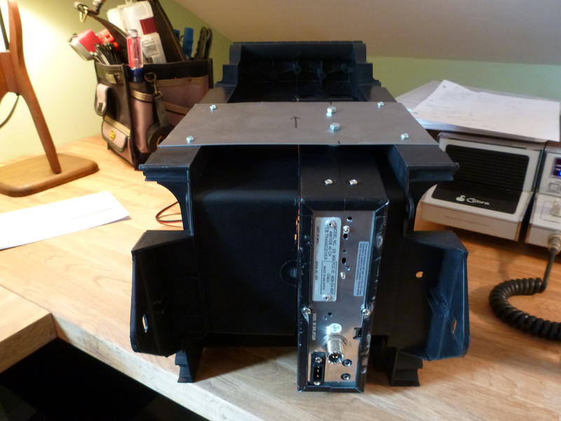

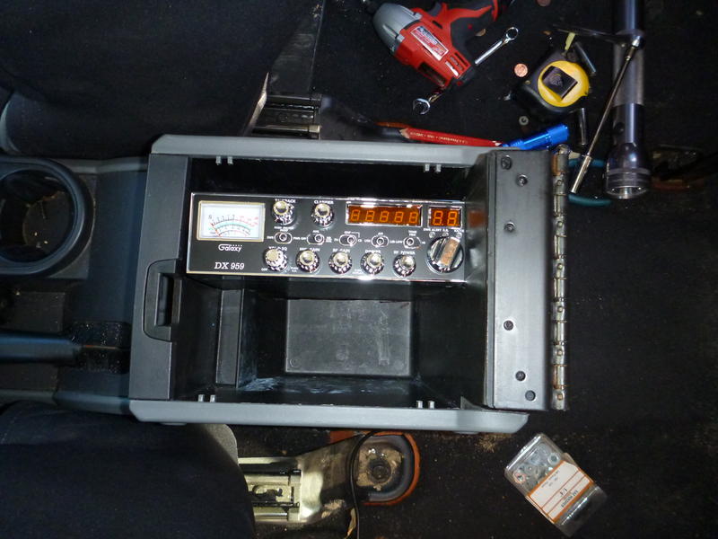

Default Galaxy 959 in Center Console
This is a work in progress......I am probably going to be all buttoned up in a day. For my CB I really wanted single side band. That limits the selection and they also start to get pretty big. The Galaxy 959 is a great unit. It is however very big!!!! I tried many possibilities but it was just too big! In progress now is modifying the center console so it fits inside nicely with the stock lid. I had to cut a slot out of the interior tub so it would fit. Additional modifications were required under the tub to the brackets, yaw sensor. I will do a full write up soon but here are some sneak peaks:
Looking down (lid not installed now)

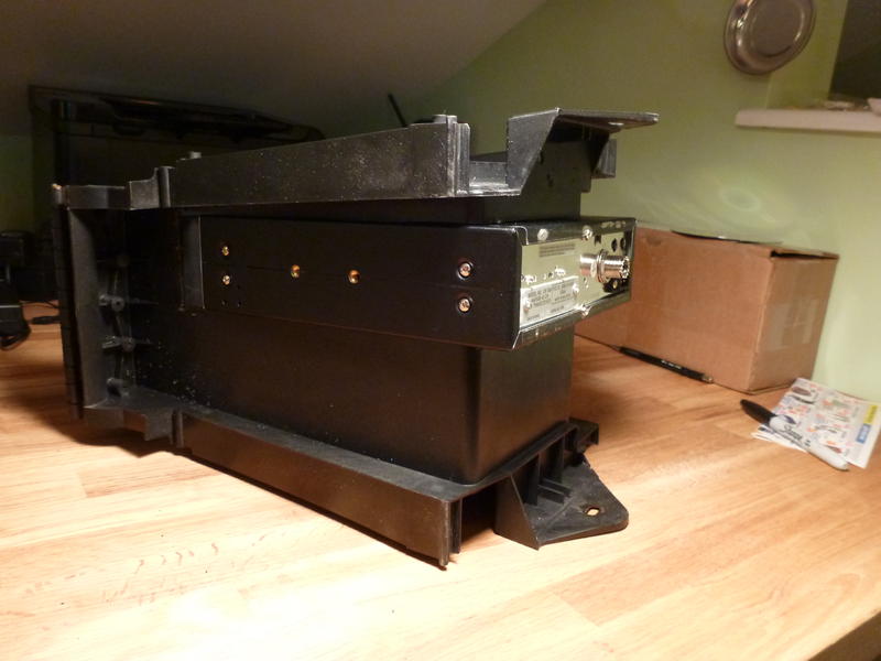

The modified tub to fit the 959
I used some flat metal stock to hold up the CB. Nylon spacers made up the difference in space.

Power is 10 gauge wire straight from the the battery where there is an ATC style fuse in line with the wire. That hole in the behind the side access cover is VERY convenient!! It gets you into the engine compartment with ease!
I will update more soon. What I do like about the location is that it is still stock looking and the CB is totally hidden. To bring it back will only cost me a replacement center console storage tub.
