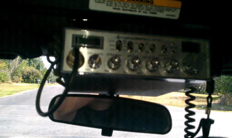

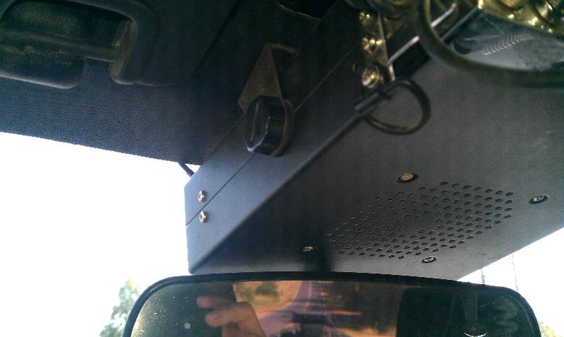

Here is a couple of pics of cb above the mirror it does work with hard top to.

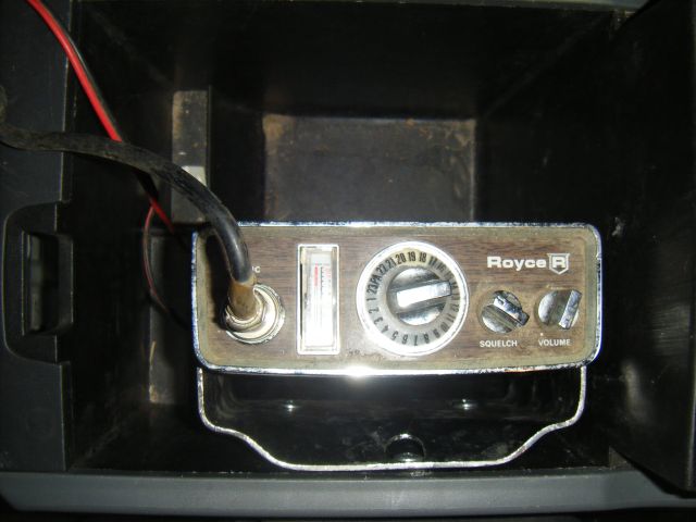

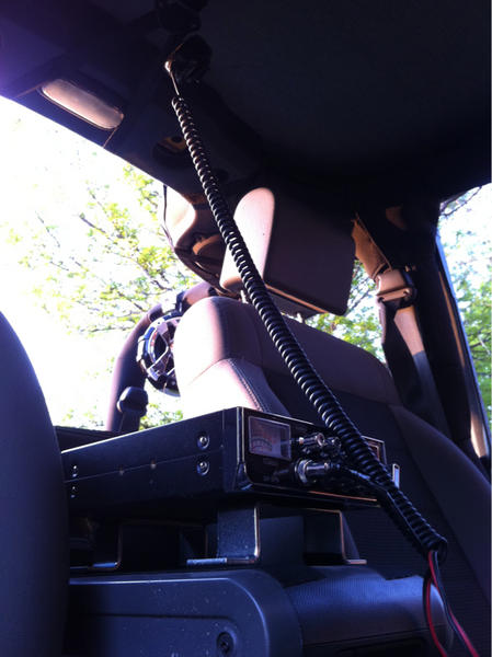

OLD school CB mounted inside center console.
The mounting bracket is one of the metal portions that were cut off when I stubbied my factory front bumper.
Incredibly cheap and easy, some would call it "ghetto," but it works and protects the CB from mud showers.
https://www.jk-forum.com/forums/jk-w...l-cheap-80045/

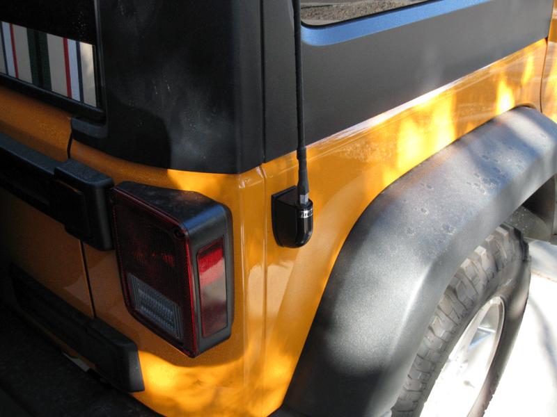

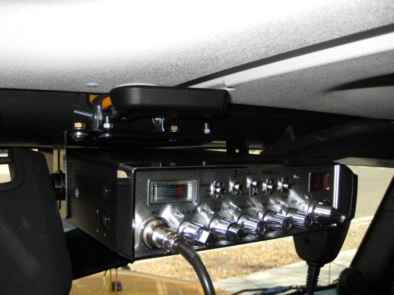

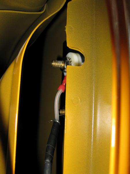

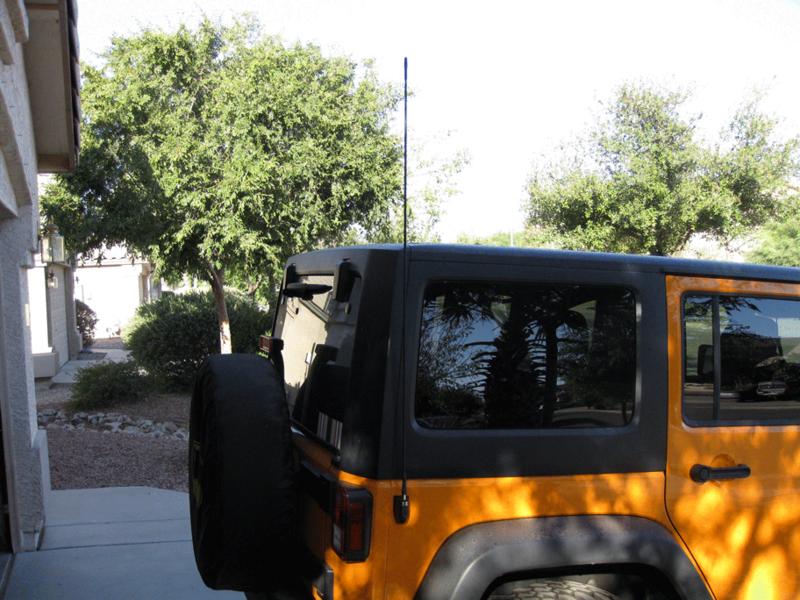

My recent CB and antenna install:
ID:	345643Click image for larger version
ID:	345644Click image for larger version
ID:	345645Click image for larger version

When you guys install the radio on top of the rear view mirror do you run the coax through the roll bar or under the carpet all the way to the back?
Any advantages or caveats using either option?
Old Jul 26, 2012 | 03:03 AM
tslewisz's Avatar
Joined: Feb 2010
Posts: 2,152
From: Bloomington, IL
I ran it under the roll bar padding from the windshield to behind the front seat and under the carpet from there. Carpet's gone now so it's zip tied with the other wires running back there at the top of the tub, passenger side.
Old Jul 26, 2012 | 05:36 AM
maverick17's Avatar
Posts: 429
From: Goodyear, AZ
I ran my coax along the top of the roll bar (under the padding) using something to fish it (a straightened hanger). I ran it all the way to the rear roll bar support and then down. Since I mounted my antenna on the passenger side... there's a rubber grommet near the rear roll cage support where the tail light cabling enters the fender... I created a small hole and ran the coax through that.
I picked up my antenna mount at a local CB supply store... and its designed to be hardwired to the coax. I went with the passenger rear corner at a friend's suggestion but I will say this was very difficult since you have to work through the taillight opening and there's a metal flange that stickes out just before the mount (you'll see it in my second pic).
The alternate location (suggested by the CB store) was to the right of the driver's taillight (between the taillight and gate). There's an indentation or thin section of the body (felt when the taillight is removed) where the mount can be attached... probably easier to wire but you'll do it blind since due to the extreme angle. The antenna will also be in the way of opening the hard top rear glass as the antenna would barely overlap.
