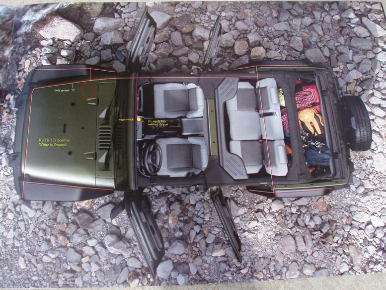

Could these be controlled by a switch and wired to come on when you unlock the jeep. Would help in the parking lot and draw attention if the alarm goes off.
Originally Posted by SFD1248
Did I miss a write up in all the pages of where you ran all the wires and to what switches if you weren't doing the lights on when unlocking? Just curious as to where all you ran them. Can these lights be used on Stock Sahara fenders also?
TIA
Andrew
Ummm yep you missed a lot, time to start reading...LOL
As for the stock Sahara fenders yes you can but you will need to pick up some aluminum stock from Home Depot or Lowes to make some brackets for the LEDS.. or you can do some of locations that others have posted on here. I wanted the LEDS to be as far out to the edge as possible so I could have light out by the sidewall of the tire.
That's exactly how they are wired here. That's what the DIODE is for....

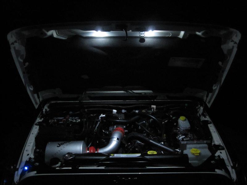

This looks like a great thing to add under the hood. I was looking at my rubicon and I have a "hood pin switch" that is located near the windshield washer fluid tank. This is used for the remote start so you can not remote the vehicle if the hood is open. This switch is a ground switch and the side that you would want would be the purple with bluish grey stripe. This wire is only neg when the hood is open. Wire up your lights to a 12v source and wire the neg side to the purple/blue-grey stripe wire and BING BANG BONG these lights come on only when the hood is open. Switch is a good idea if you dont have the hood pin switch, but you can forget it and leave them on....I have seen these switches everywhere and they are a couple bucks is all(if yours doesnt have one allready). Fully adjustable too so if the hood sits higher even when closed it will still be off. PM me if you need any other help.
Originally Posted by whpony96
These also work great for under the hood work lights!
