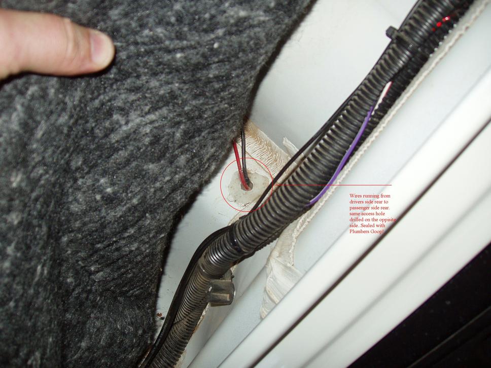

whpony96 - what gauge wire did you run, and where did you run it through?
I'm pretty sure I used 18 gauge wire. I ran paired wire all the way around as well (meaning I used only 1 grounding point for the entire system) I drilled only 2 holes for wiring purposes.
The main harness begins feeding the passenger front wheel well then from the battery through the firewall along the lower plastic trim to the passenger side rear door area (splitting into the passenger rear wheel well) then across behind the seats and under the carpet to the drivers side rear door area inside the JK and to the drivers side rear wheel well (see photos).. The secondary harness runs from the drivers front well runs across the front grill to meet the main harness by the battery. .
You can supply voltage anywhere you want. I applied mine by the battery where the primary and secondary harness meet. but you can tap the switched 12v cigar lighter port inside the cab and then just add a switch. This is totally up to you..
ID:	27404   Click image for larger version
