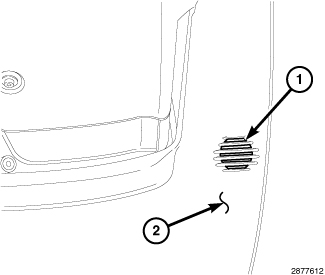

Does anyone know where the following sensor is located? I have the sensor just have no clue as to where to install it.
SENSOR. Temperature Cabin Air.
Stock Code 55111178AC
Description: SENSOR. Temperature Cabin Air. . "Instrument Panel Parts Module"+"Air Conditioning w/Auto Temp Control". Required: 001
I upgraded my AC/Heat control module to an Automatic Temperature control unit, and I believe this sensor will make it work better. It is working OK now, but could work better in certain situations.
ID:	328747Click image for larger version
Name:	sensor in car atc.jpg
here it is. got some major issues with wiring if jeep wasnt built with this
located on right side just below sterring column
you will also need the vent holes in plastic cover below steering column

Great info. Thanks. Any ideas of what it wires into? I suspect I'll find a wiring harness behind the cover.

it wires to the atc head.
ties in to the evaporator sensor also.
dont know if wiring is there on all jeeps.
cant see your atc working corectly without this sensor....Good Luck

I popped off that panel in hopes of seeing a wiring harness dongle there but didn't see one. That sensor that you ordered, does it have any wiring on it or is it just a sensor that screws in right behind the slotted part of that panel?

Any other information where this came from, definitely helpful, curious on the wiring harnesses needed.

The sensor has a spot on the back that a harness plugs into. I'll take some pics tomorrow.
