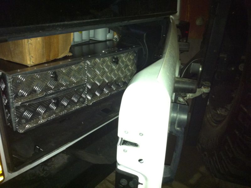

I used to store stuff in boxes. This time, I decided on drawers, which allow direct access to what's on the bottom, especially to what's "buried" deeper, near the back seat.
At first, I thought of making wood drawers, but wood would have been much thicker and occupy precious space. Thinner & lighter Aluminium seemed to be better.
Name:	Jeep Drawers.jpg
There's 1 deep drawer and 2 more shallow ones, which I ordered along with their lockers and heavy duty telescopic rails.
The frame is made of 'L' shaped Aluminium, cut to size and riveted together.
For the top, I used marine-grade plywood, finished with 3 layers of durable yacht varnish (lightly sanded after each layer has dried).
The drawers contain tools, pneumatic impact wrench & cutting disc, shackles, small stuff like deflators, etc'.
The fridge, water, Maxpedition bags with medical & survival stuff, portable ARB compressor etc', are tied on top.
I intend to add modular tie down Aluminium rails (along the sides, near the top), for tying down whatever is put on top. (Google for - uscargocontrol.com or similar, " 24'' Aluminum Logistic Tie Down Track", Part: AT24AL". There're other sources.)
I, too, don't like rattling. The heavy duty drawer rails are silent even during trail sprints.
The tools are padded with some ~0.4" foam, cut from a thin camping mattress. It's all absolutely silent.
The drawer box is strapped to the tie downs on the floor.
The straps will be replaced with DeStaco (or similar) latches, rated to hold at least x2 the loaded weight. The latches will be mounted on the sides of the drawer box, so the top stays flat.
There's just enough space to stick a folding chair on either side. There's also a bit of space between the box and the subwoofer, so it's not blocked.
If you want a shelf but no drawers, there's a good one by onboardair.com – 'JK rear interior storage rack', part # JK-R1 – which you can buy, or make something similar. It's rated for 300 lbs, which is impressive.

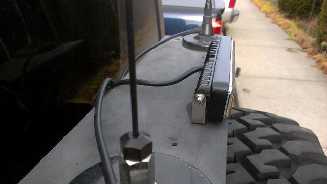

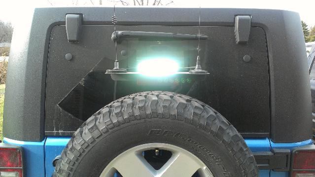

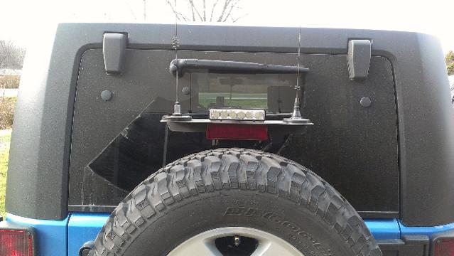

I just bought these from Blitspro. Its model 6lz. I have only had it on for a month but they seem to be decent quality and put out enough light for $30.

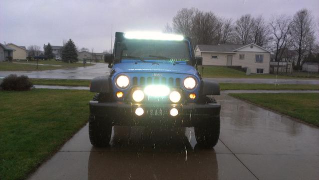

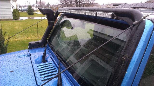

I also installed 7 of them across the face of a Rugged Ridge windshield light bar for flooding everything up close with light.
