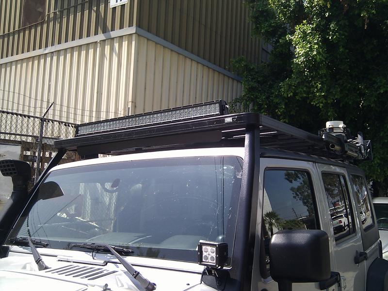

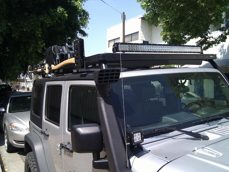

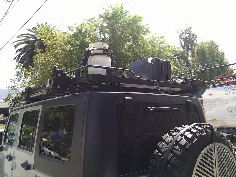

It's super sunny today, but here you go!
Attachment 456029
Attachment 456030
Attachment 456031

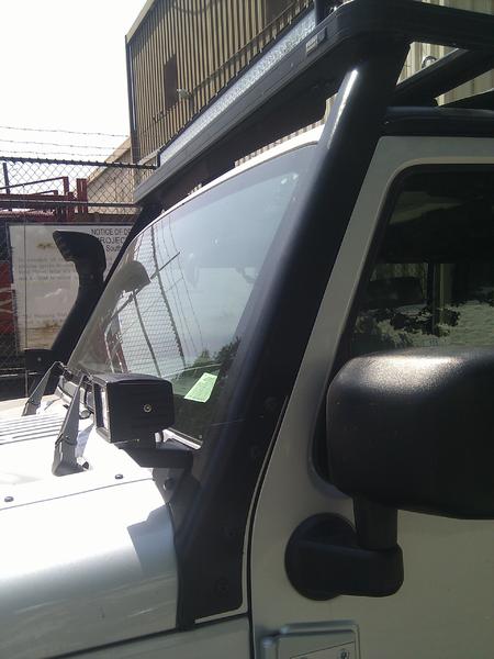

The front is attached to the A pillars via flat pillar brackets.
Attachment 456033

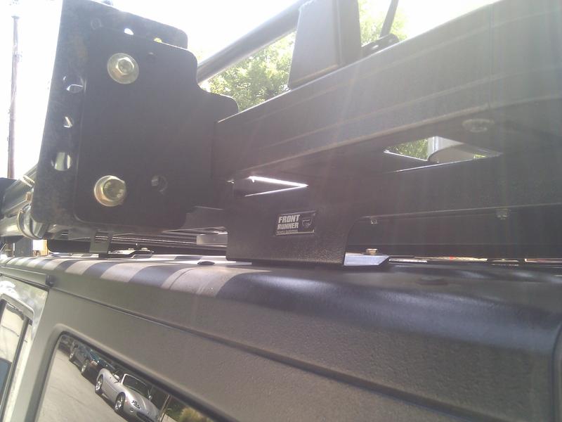

The Rear is a passthrough design that allows for the rack to be mounted to the rollbars.
Attachment 456034
I havent tried it yet but the rack can be removed and installed on the jeep while topless and the freedom panels can come out easily with the rack installed.
It's incredibly strong.
http://youtu.be/Tz-Zw5cyBEo As far as soft tops, I don't think that there is a solution yet. I immagine you could mount it to the rollbars when topless and possibly attach it if the back side windows were removed/unzipped. I don't have one so I can't verify.
nice setup....I'm looking hard at this rack.i don't plan on using my rag top that came with my 5dr.i am wondering why u installed that light bar on top of the rack instead of under or in front of the cross bar........I'd think it would get hit by tree limbs out on the trail??? any issues as of yet with it?

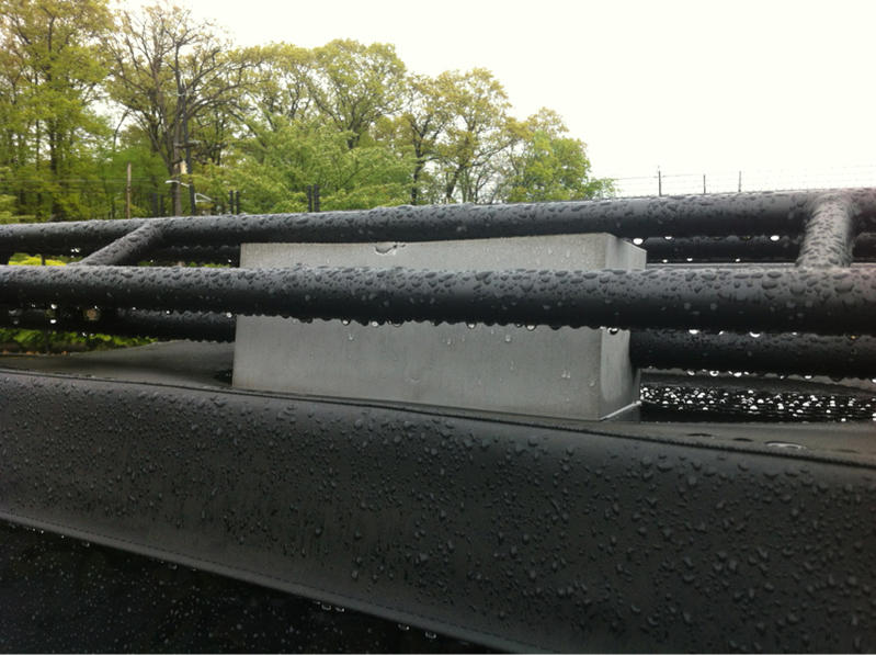

Here is the foam I used on top of the rack:
It's a Malone kayak pad.
I also used skid row off roads' "top prop." Google it, between the two, no more flapping.

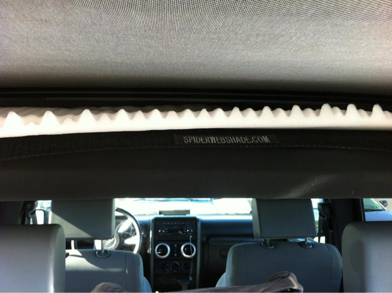

For the wind noise generated from the roof rack,, this $12 full sized mattress pad from Walmart made a huge difference:

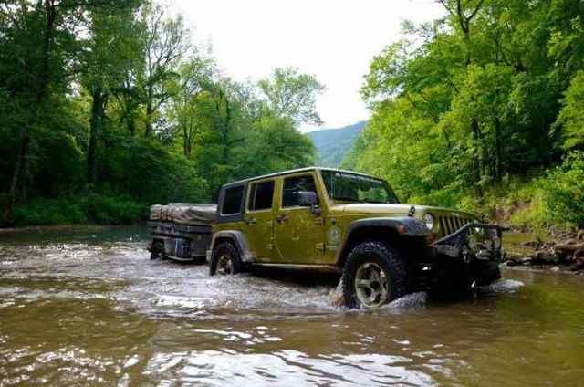

Yes, they are spare tire rims. Off the Grand Cherokee from a few years back. Steel rims that should be used with spacers. The owner had a difficult time finding seven of them (Jeep, trailer and two spares). He had them sandblasted and powdercoated locally. Buried somewhere in this thread are the old and new part numbers for these rims. I looked, but wasn't successful in finding it. But, I know I put it out there a while back.
Here are a couple more pics of the rig ...
White Rim Trail in Canyonlands
Canadian River near Bridgeport, OK
