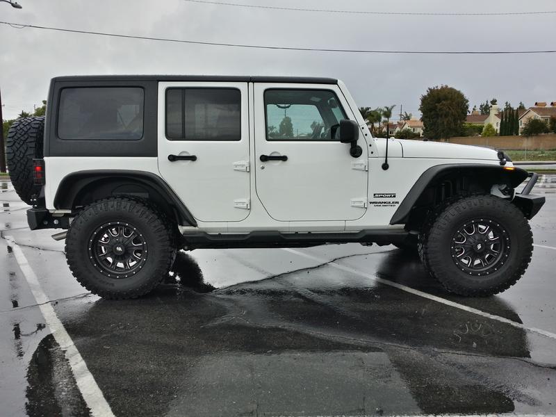

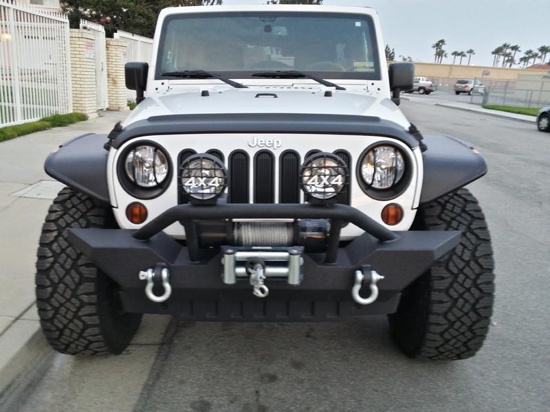

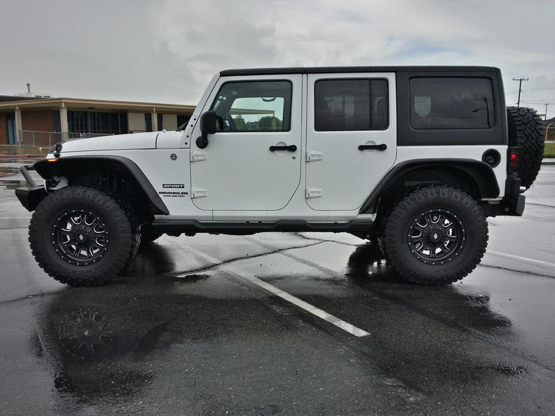

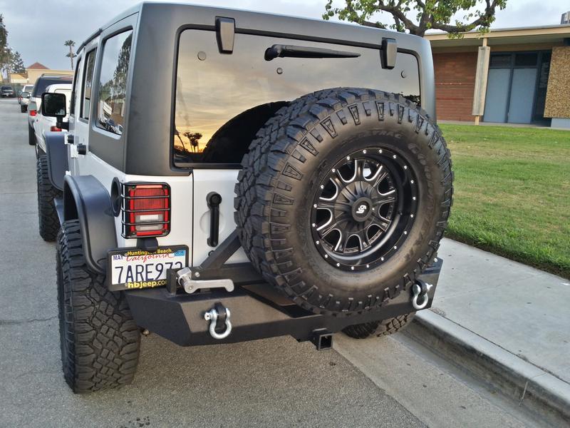

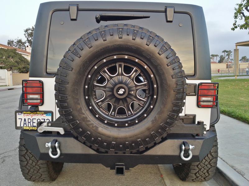

Default 2013 JK Unlimited setup for Overlanding
I went with a 1.75" leveling kit on the front, no spacers on the back springs. Decided to "lift" the fenders instead. The tires are 315x70x17 on 4.5 backspace rims, 3.73 gears. I also added a Swaybar quick disconnect in the frot and Sumosprings in the back to help bottoming out. Added the Superchip programmer setup for 91 fuel tune and get 14.5 around town and 19~20 on the road.
My only problem now is I am still trimming the rear inner fender area to help with a minor rub on the front of the rear tire. The 2013 JK's already have the lover pinch seam trimmed from the factory.

You didn't add any bump stops? You need extended bump stops for 35's, lifted or not. That, or A LOT of trimming.
Rig looks good!
